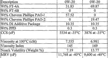

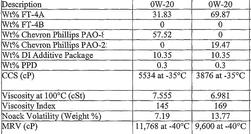

5 hours ago, SAE20 said:
I would, after all, take for winters (when often below -15) something more classic - which is easy to find, by the way
5000 and below at -35C ( CCS ) - optimal
PP can be watched too
in general it's just 0W-20 with GTL / PAO content
And how the composition affects - it is easy (rough of course) to understand in the picture -
NOACK at 13.77% frightens me!
Изменено пользователем elgouyu
Spelling
21 минуту назад, elgouyu сказал:
NOACK at 13.77% frightends me!
Samples of the composition are drafts rather than finished pieces.
