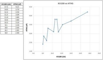

SAE20
Is it TRUE?
Taken from BITOG.
Изменено пользователем muxxxx

14 часов назад, muxxxx сказал:
Sorry, I do not get it.
Is it TRUE?
A definition of truth is narrow: truth would be defined only for strictly exact assertions.
Now, whether or not that is true, it is useless to look for a mere relation between HTHSV and KV100.
As can be seen from Table the HTHS viscosity depends on several factors, for example, a type of base oil which responds differently to high shear at elevated temperatures.
Table
