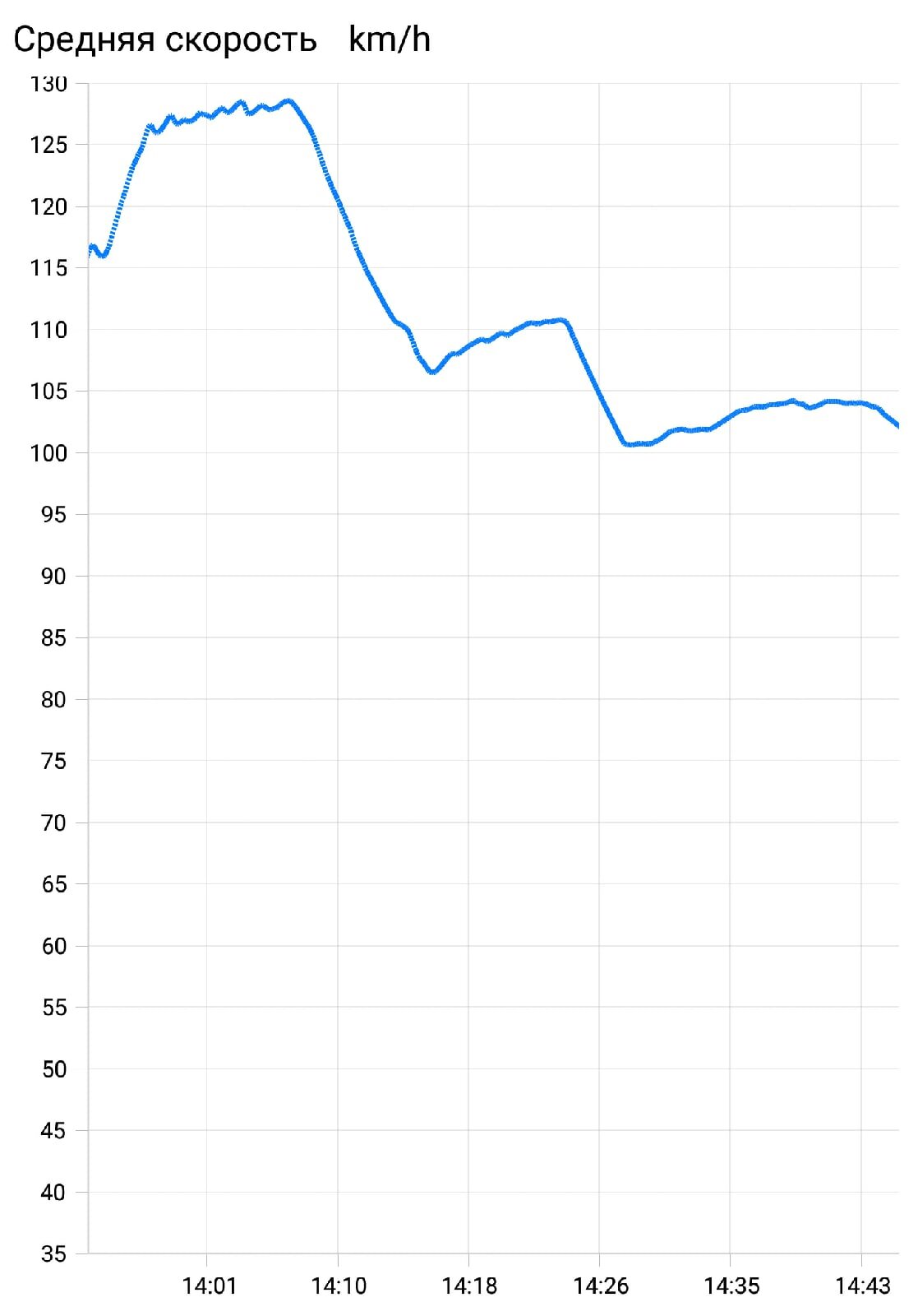

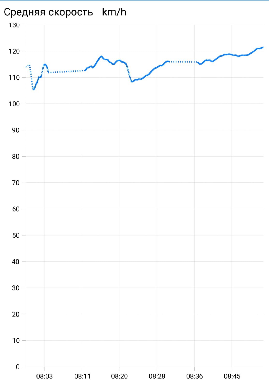

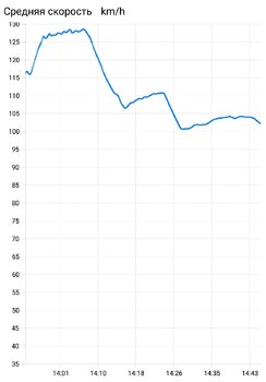

GaYK0VfC_xo.thumb.jpg.87b8f1f675bcd6994c58e4ba4f92a3ab.jpg5DYnfCODOF8.thumb.jpg.007c81332c253b3eff7e6838e9d46662.jpg
723579506_nFU8zl164qc(1).thumb.jpg.b9d5d312b466fd54675b0310332ad595.jpg 491544081_UUoQQgGzWlA(1).thumb.jpg.9a4821e11a65aaa00d3a4f62eb80e64b.jpg

GaYK0VfC_xo.thumb.jpg.2da371ccc15f4d9647f31928793bc694.jpg 5DYnfCODOF8.thumb.jpg.2553eb9717f0277c7f44da548d1f0cec.jpg
