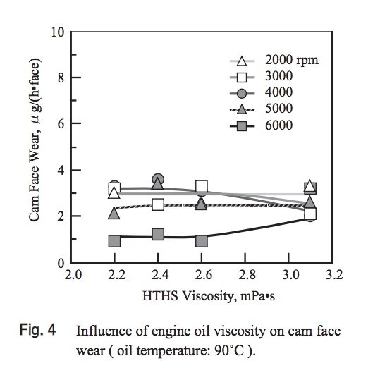

 И реальные моторные тесты, с понижением HTHS не на 10% (с 3.5 вниз) , а сразу на 25% ?
The mechanical engine performance is also analyzed with a fully synthetic low-viscosity lubricant (0W20) and the results are compared to the results with the reference lubricant (0W30). The trends of the friction torque over speed and load are identical for both lubricants. Hence, the presence of metal–metal contact in the lubricated contacts appears unlikely as it would furthermore lead to a raised friction torque.
A reduction potential of the overall engine friction losses by using 0W20 is identified for the entire investigated engine speed and load range. At a media temperature of 90 ◦C, the friction losses are cut down by roughly 5% at motored condition and under load at an engine speed of 2000 rpm. It is interesting to note that an almost 25% difference in HTHS-viscosity (3.2 mPa·s vs. 2.6 mPa·s) is needed to obtain this 5% friction reduction benefit for the 0W20.
The main bearing temperatures are also evaluated for both lubricants. Friction in the bearings causes heat and the bearing temperature increases as a consequence. Due to lower friction losses in the bearings when using 0W20 instead of 0W30, a lower temperature is observed. The bearing temperature would increase if metal–metal contact is present. Hence, it can be assumed that the main bearings operate in pure hydrodynamic lubrication regime.
данный тест показывает лиш снижение потерь на трение при переходе с 0W30  на 0W20, при этом выигрыш всего 5% против снижения HTHS на 25%, остальное (износ например)  на уровне "хайли лайкли",
масла меньшей вязкости обеспечивают прокачку большего количества  через зазоры пар трения и соответственно это снижает температуру в узле
даже если будит происходить кратковременный контакт метал--метал
вот такой график показывает более конкретно величину износа при конкретном условии

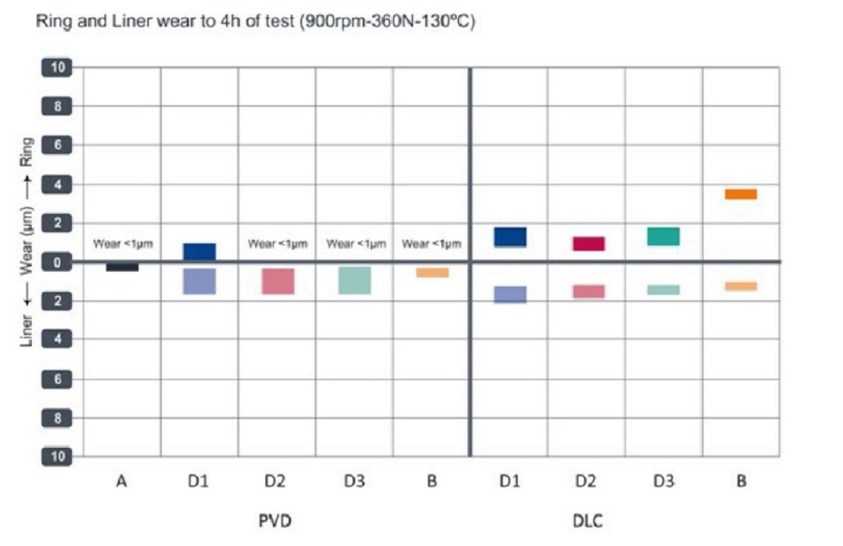

""All three formulations were able to achieve CoF of ~0.04 (superlubricity) under boundary
conditions with the PVDC rings. As with all the other tested oils, DLC friction remained
similar to the baseline oil. To assure repeatable conditions, Oils A and B were tested
again together with the three new experimental formulations. On this test round, the Oil B
- DLC ring pair confirmed the friction increase with wear trend observed in the 1 tests.
In terms of wear, although it was still higher for DLC (and in the paired liner) than for the
PVDC with oils containing molybdenum, the three new formulations were able to mitigate
the ring wear compared to the commercial Oil B.
The work undertaken has demonstrated that real-world superlubricity (low friction values
of ≤0.04 CoF) can be obtained between a PVDC coated piston ring and a cylinder liner in
reciprocating motion with high molybdenum containing oils. In addition, when superlubricity
occurred, both ring and liner wear were reduced. However, high molybdenum containing
oils caused increased wear on DLC coatings, which can be mitigated with the correct
lubricant formulation
By carefully balancing the additive components in lubricant
formulations superlubricity can be achieved in real-world
conditions with fully formulated SAE 0W-20 oils.
Taking advantage of the synergic effects of specific combinations of coatings and
lubricant additives it is possible to gain fuel economy benefits by reducing engine friction
losses while maintaining wear protection.""
7 часов назад, SAE20 сказал:
Итак, вы полагаете и даже утверждаете, что KV100 10(±1) + HTHS  3.1(±0.1) = стружка.
Другими словами, вы экспонировали вашу априорную перцепцию "ущербности А5 масла" на апагогические постулаты Рено-форума и тем самым вывели прецизионный силлогизм "А5 - продуцирует стружку, ибо A5 масло громко стучит, а стук молотком по железу - , casus ordinarius, - стружка"
Pro rata. Браво, коллега, это - Нобелевка!
Я готов признать обскурантизм моего синопсиса - "HTHS < 3.5", я резигнирован.
Простите, что встреваю, но вы могли бы прокомментировать эти чудные графики? Интересно они построены на основании данных по износу реновского мотора, или как обычно, на основании данных "приборчикоф"? ;)
24 минуты назад, Mikong сказал:
Взято от сюда, наверное: https://www.oil-club.ru/maslo-s-kakim-hths-vybrat/
11 минут назад, sanchell сказал:
Работа известная, старинная, но у меня "оригинал"
