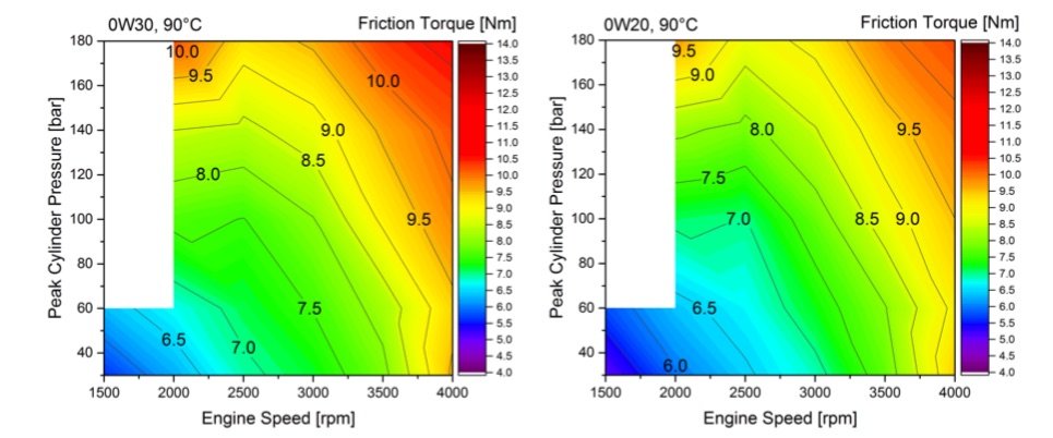

А вы видели вот такие картинки про не очень современный реношный дизелёк ? Я уже давал..
И реальные моторные тесты, с понижением HTHS не на 10% (с 3.5 вниз) , а сразу на 25% ?
The mechanical engine performance is also analyzed with a fully synthetic low-viscosity lubricant (0W20) and the results are compared to the results with the reference lubricant (0W30). The trends of the friction torque over speed and load are identical for both lubricants. Hence, the presence of metal–metal contact in the lubricated contacts appears unlikely as it would furthermore lead to a raised friction torque.
A reduction potential of the overall engine friction losses by using 0W20 is identified for the entire investigated engine speed and load range. At a media temperature of 90 ◦C, the friction losses are cut down by roughly 5% at motored condition and under load at an engine speed of 2000 rpm. It is interesting to note that an almost 25% difference in HTHS-viscosity (3.2 mPa·s vs. 2.6 mPa·s) is needed to obtain this 5% friction reduction benefit for the 0W20.
The main bearing temperatures are also evaluated for both lubricants. Friction in the bearings causes heat and the bearing temperature increases as a consequence. Due to lower friction losses in the bearings when using 0W20 instead of 0W30, a lower temperature is observed. The bearing temperature would increase if metal–metal contact is present. Hence, it can be assumed that the main bearings operate in pure hydrodynamic lubrication regime.
