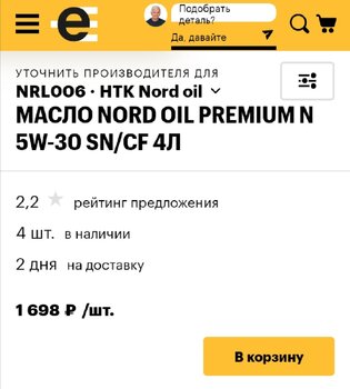

NRL005 - Nord Oil Premium N 5W-30 1 л.
NRL006 - Nord Oil Premium N 5W-30 4 л.
NRL008 - Nord Oil Premium N 5W-30 205 л.
