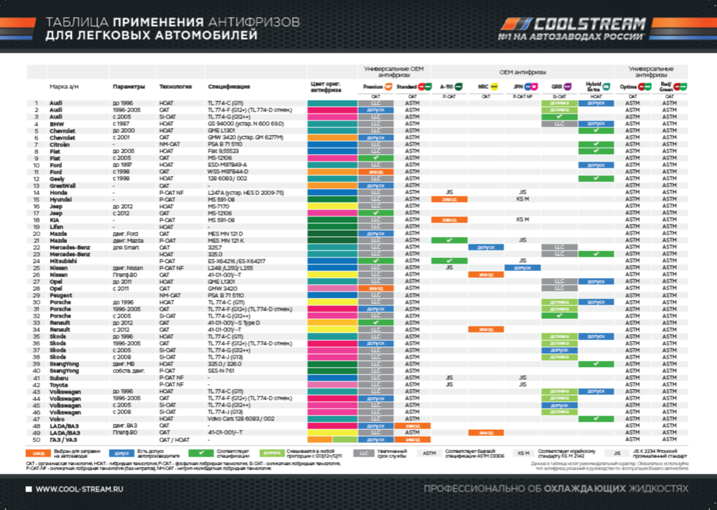

Рекомендации Arteco по применению антифризов
Havoline XLC = Coolstream Premium
Havoline AFC = Coolstream Hybrid Extra
Freecor QFC = Coolstream G13
Freecor QRC = Coolstream QRC
Freecor LPC = Coolstream JPN
Freecor HDC (он же Caterpillar NGEC / DEAC) = Coolstream HDC
Havoline XLI = Coolstream XLI
Freecor DSC = Coolstream DSC
Freecor NRC = Coolstream NRC
