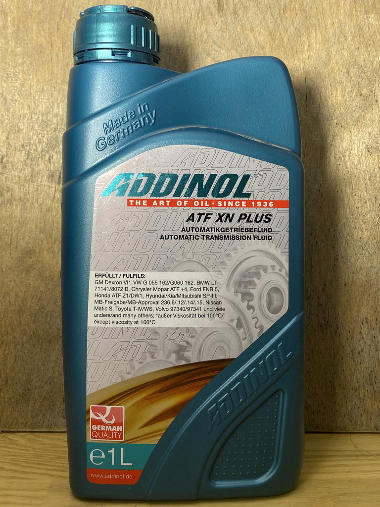

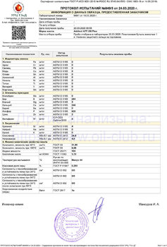

Addinol ATF XN Plus свежее за анализ спасибо товарищу @nikulum
Масло в лабораторию слал @nikulum в запечатанной таре.
Видео вскрытия в лаборатории УРЦТЭиД:
Addinol ATF XN Plus URC копия.jpgAddinol ATF XN Plus Photo1.JPGAddinol ATF XN Plus photo2.JPGAddinol ATF XN Plus photo3.JPG
Масло заявлено как: GM Dexron II D, GM Dexron III H, GM Dexron III G, GM Dexron II E, GM Dexron VI (except of viscosity at 100°C), Allison C4, MAN 339 V1, MAN 339 Z1, MAN 339 Z2, MB 236.1, MB 236.2, MB 236.5, MB 236.7, ZF TE-ML 03D, ZF TE-ML 04D, ZF TE-ML 11B, ZF TE-ML 14A, ZF TE-ML 14B, ZF TE-ML 16L, ZF TE-ML 17C, Aisin Warner AW-1, Allison TES-295, VW G 055 025, VW G 052 162, BMW ETL-7045E, BMW LA 2634, BMW LT 71141, ATF D VI, VW G 052 025, ZF TE-ML 05L, ZF TE-ML 09, Volvo 97340, Volvo 97341 (AT 101), Ford Mercon, Ford Mercon V, Ford FNR5, Honda ATF-Z1, Hyundai SP-II, Hyundai SP-III, Hyundai NWS 9638, Aisin Warner JWS 3309, Idemitsu K17, KIA SP-II, KIA SP-III, MAN 339 F, MAN 339 V2, MAZDA ATF M-III, MAZDA ATF M-V (M-5), Mitsubishi SP-II, Mitsubishi SP-III, MB 236.6, MB 236.9, MB 236.10, MB 236.11, Nissan Matic-D, Nissan Matic-J, Nissan Matic-K, Nissan Matic-S, Subaru ATF, Subaru ATF-HP, Toyota T-III, Toyota T-IV, Toyota ATF WS, Voith H55.6335.XX (G607), Voith H55.6336.XX (G1363), MB 236.14, MB 236.15, MB 236.12, MB 236.3, MB 236.81, MB 236.91, VW G 052 990, Chrysler Mopar ATF +3, Chrysler MS-9602 (Mopar ATF +4), Toyota T, Toyota T-II, BMW M-1375.4, BMW ETL-8072B, BMW Dexron VI, Volvo 1161540, VW G 055 005, VW G 055 162, VW G 055 540, VW G 060 162, GM 1940767, GM 1940771, GM 1940773, Jaguar C2C 8432, Ford WSS-M2C924-A, KIA Red-1, Hyundai RED-1, GM 1940184, Suzuki ATF 3317, Land Rover TYK500050, Land Rover LR002748, BMW M-L12108, Saab 93165414, Lexus Type T-IV, Honda ATF-DW1, BMW ATF 3+, BMW ATF 6, Jaguar 02JDE 26444, GM/Opel 19 40 774, Saab 93165147, Suzuki ATF 3314, Volvo Pass Car 4-6 speed, Aisin Warner JWS 3324, Mitsubishi ATF J2.
ИК спектр Фурье
