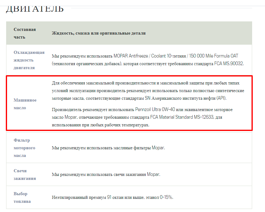

(For best performance and maximum protection under all types of operating conditions, the manufacturer only recommends full synthetic engine oils that meet the American Petroleum Institute (API) categories of SM or SM/CF, and meet the requirements of Chrysler Material Standard MS-10725. The manufacturer recommends the use of a full synthetic engine oil, such as Pennzoil Platinum® European Formula SAE 5W-40 or equivalent.)
Если зайти на официальный сайт Jeep.com и выбрать Jeep Grand Cherokee SRT то рекомендуется масло Pennzoil Ultra 0W-40 и допуск API SN MS-12633.
Этот допуск пишут все кому не лень в 0W-40:
