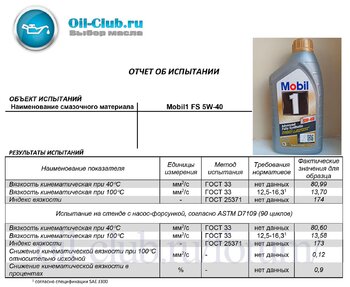

Mobil1 FS 5W-40 NEW 2021 свежее Shear Stability
Mobil1 FS 5W-40 NEW 2021 свежее Shear Stability за анализ спасибо urman, itseasy, parziv, resh77.

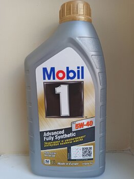

Mobil1 FS 5W-40 Shear Stability копия.jpgMobil1 FS 5W-40 photo1.jpgMobil1 FS 5W-40 photo2.jpg
Масло заявлено как: API SN/SM, ACEA A3/B3/B4, MB 229.3/229.5, VW 502.00/505.00, PORSCHE A40.
