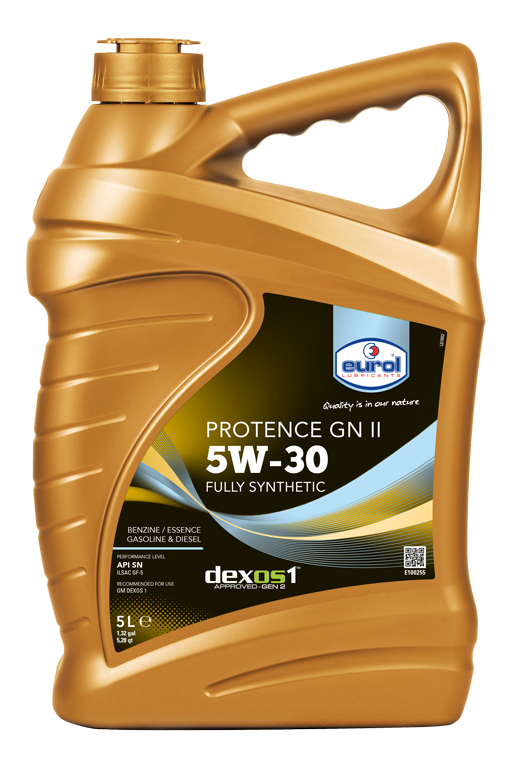

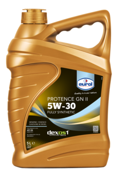

Eurol Protence 5W-30 GN II (SN, ILSAC GF-5,  GM dexos1™ Gen 2, GM dexos 1)
Спецификации:  API SN, ILSAC GF-5,  GM dexos1™ Gen 2, GM dexos 1
Техническая документация:  7522-eurol-protence-5w-30-gn-ii.pdf
E1002555L - Eurol Protence 5W-30 GN II 5L
E10025560L - Eurol Protence 5W-30 GN II 60L
E100255210L - Eurol Protence 5W-30 GN II 210L
E10016360L - Eurol Protence 5W-30 GN II 60L
E100163210L - Eurol Protence 5W-30 GN II 210L
