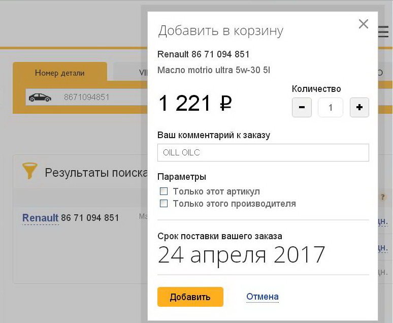

8671094851 - Motrio Ultra Oil 5W-30 5л
8671000081 - Motrio Ultra Oil 5W-30 1л
8671000081 - RENAULT 5W-30 1л
