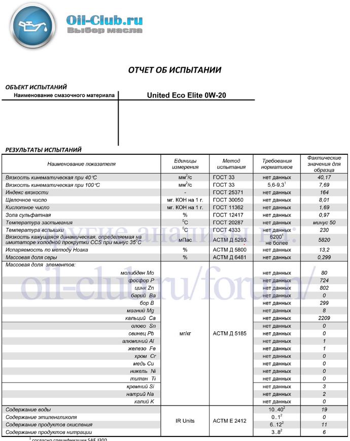

United Eco Elite 0w-20 is very same oil.(same additive package)
but United Eco Elite 0w-20 sufler is 0.328.
zic x7 fe 0w20 is 0.223.
i guess there is a difference in base oil quality.
Изменено пользователем torocon
, Yes, this is Afton Hitec 11100 :)
zic x7 fe 0w- 20 /sulfer 0.223 / noack 10.9
united eco elite 0w-20 / sulfer 0.299 / noack 13.2
wolf eco tech 0w-20 /  sulfer 0.277 / noack 13.0 (less 5%? Afton Hitec 11180 additive package adding)
same additive ..but sulfur and noack is very different.
I think this difference is caused by base oil quility.
a lot of sulfur suspected to contain a little lower quility base oil.
Any other reason?I guess ..maybe not.

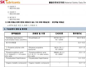

I sent an e-mail to the sk lub, and received zic x7 fe 100% yubase GROUP III synthesis.
In Korea, ZIC X7 FE 0W IS 100% synthetic oil labeled.
zic x7 fe 0w20 and zic x7 fe 0w30 have an oil base? the additive package is the same.
In Korea,
zic x7 5w is synthetic oil label,
zic x7 fe 0w is 100% synthetic oil label.
According to the sk marketing policy, (ex:zic x7 5w)100% synthetic oil was labeled as synthetic.
very Funny policy.
According to msds , russia zic x5 5w30 is Group III, but semi labeling.
i guess

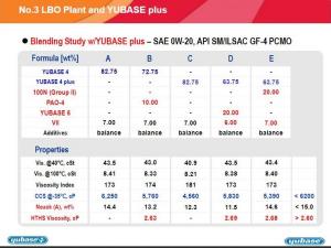

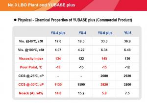

zic x7 5w is yubase(4,6)
zic x7 0w is yubase plus (4plus, 6 ??) contained
Perhaps zic x9 line... yubase plus(yubase4 plus, yubase 6plus) is included at a very high rate.
i think ..Sometimes the additive & base oil formulation fails(zic x7 fe 0w20 ccs...),  base oil quility is best among vhvi-hydrocracking
