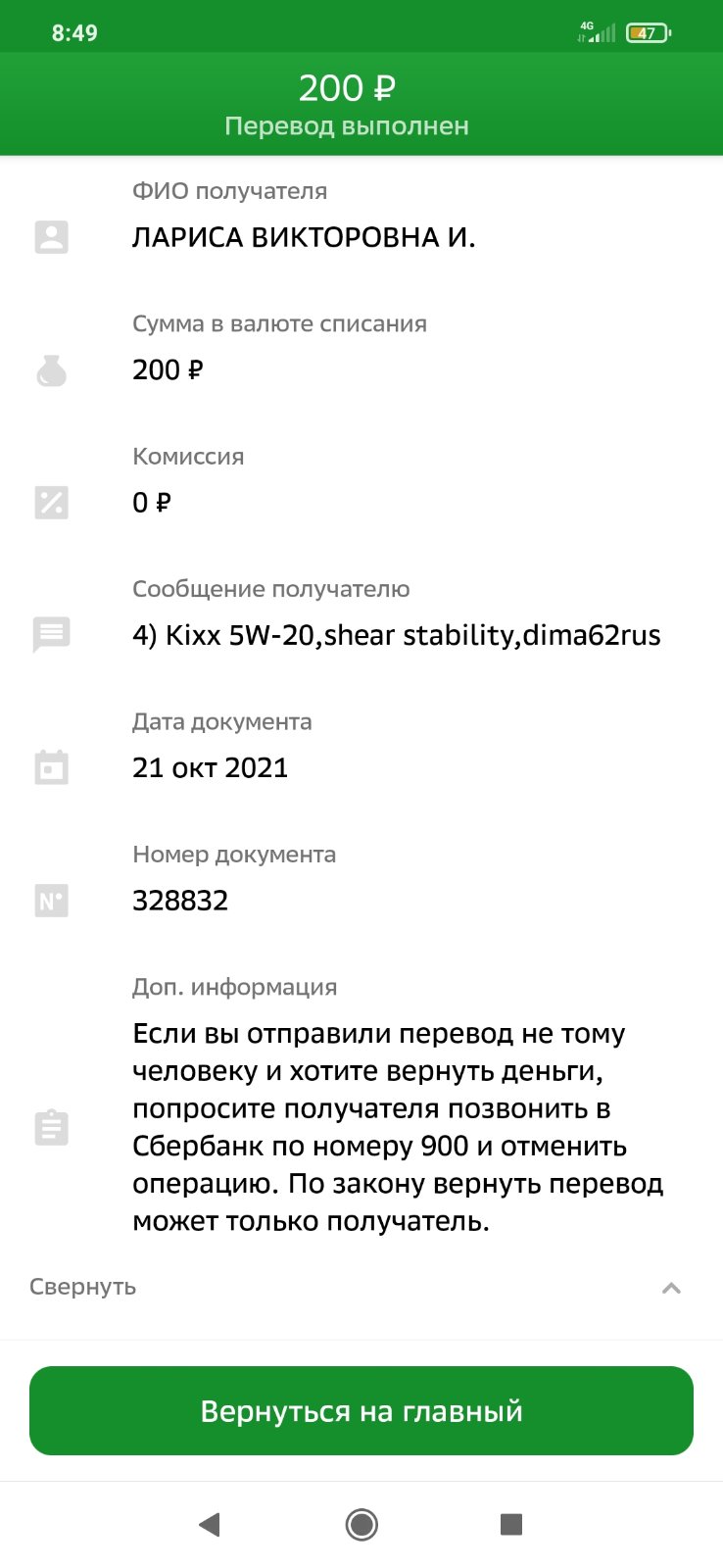

4) Kixx G1 5W-20 API SN Plus
Screenshot_2021-10-21-08-49-35-863_ru.sberbankmobile.thumb.jpg.10ce56a945c235bdb09c9a11b7fc428f.jpg
