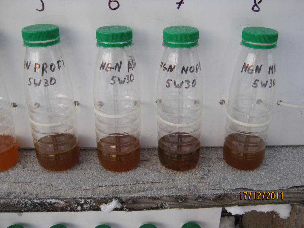

17 декабря 201114 г -26 Моторные масла 5W-30 Tyumen West Sibiria. Motor Oil 5W-30 in cold winter -26. Numbers (Номера масел) 1) Addinol Super Power MV0537 5W-30 2) NGN Diamond 5W-30 3) Addinol Super Power MV0537 FD 5W-30 4) Petro-Canada Supreme Synthetic SN 5W-30 5) NGN Profi 5W-30 6) NGN Agate 5W-30 7) NGN Nord 5W-30 8) NGN Maxi 5W-30 Winners (победители по местам) 1) NGN Nord 5W-30, NGN Agate 5W-30 2) Addinol Super Power MV0537 FD 5W-30 3) Petro-Canada Supreme Synthetic SN 5W-30 и Addinol Super Power MV0537 5W-30 и NGN Profi 5W-30 и NGN Maxi 5W-30 4) NGN Diamond 5W-30 Фотографии по прозрачности и цвету в -26

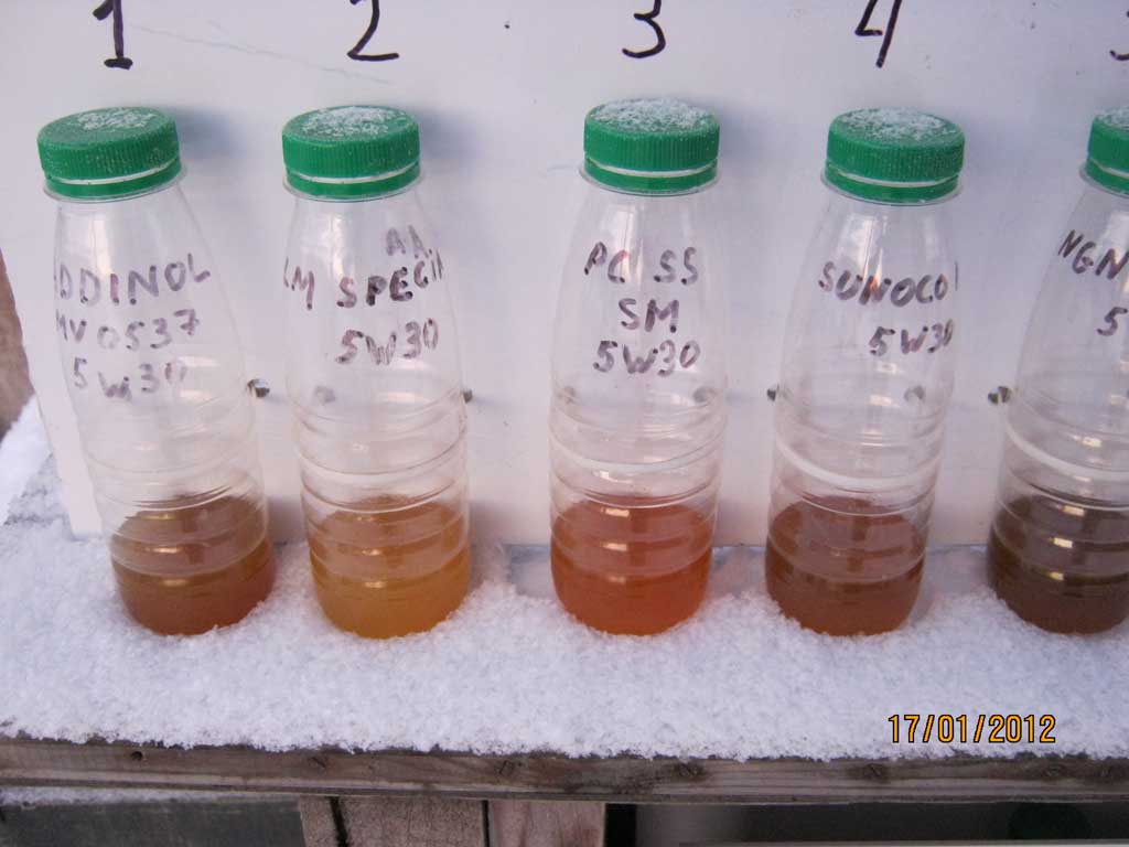

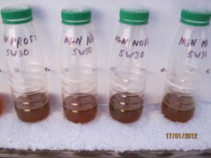

18 января 201214 г -31 Масла вязкости 5W-30 Numbers (Номера масел) 1) Addinol Super Power MV0537 5W-30 2) Liqui-Moly Special AA 5W30 3) Petro-Canada Supreme Synthetic SN 5W-30 4) Sunoco Synturo Mistral 5W-30 5) NGN Profi 5W-30 6) NGN Agate 5W-30 7) NGN Nord 5W-30 8) NGN Maxi 5W-30 Winners (победители по местам) 1) NGN Nord 5W-30 2) NGN Agate 5W-30 3) Liqui-Moly Special AA 5W30 4) Petro-Canada Supreme Synthetic SN 5W-30 5) Sunoco Synturo Mistral 5W-30 6) Addinol Super Power MV0537 5W-30 and NGN Profi 5W-30 and NGN Maxi 5W-30 -31 масла вязкости 5W-40 Numbers (Номера масел) 1) Ravenol VSi 5W-40 (Old 2010 year) 2) Ravenol VSi 5W-40 (2011 year) 3) Liqui-Moly Optimal Synth 5W-40 4) NGN Gold 5W-40 5) NGN Synt-S 5W-40 6) NGN Diesel Syn 5W-40 Winners (победители по местам) 1) Ravenol VSi 5W-40 (Old 2010 year) 2) Ravenol VSi 5W-40 (2011 year) 3) NGN Synt-S 5W-40 4) NGN Gold 5W-40 5) NGN Diesel Syn 5W-40 6) Liqui-Moly Optimal Synth 5W-40 -31 Масла вязкости 0W-30 Numbers (Номера масел) 1) Petro-canada Supreme Synthetic SN 0W-30 2) Fuchs Titan Supersyn 0W-30 3) Castrol SLX Professional Longtec 0W-30 4) Addinol Extra Light MV 038 0W-30 5) NGN Synergy 0W-30 6) Elf Excellium 0W30 Winners (победители по местам) 1) Addinol Extra Light MV 038 0W-30 2) NGN Synergy 0W-30 and Fuchs Titan Supersyn 0W-30 3) Petro-canada Supreme Synthetic SN 0W-30 and Castrol SLX Professional Longtec 0W-30 4) Elf Excellium 0W30 Фотографии прозрачности в -31: Изменено 19 ноября 201511 г пользователем ModeratorSigma
