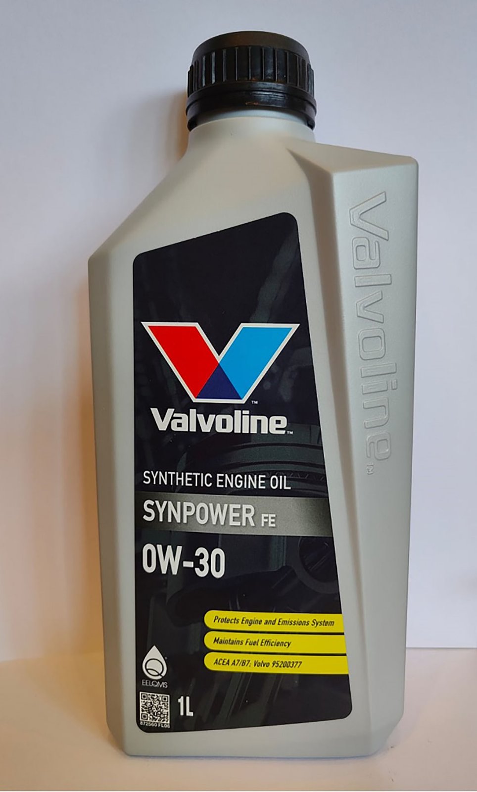

Valvoline SynPower FE 0W-30 ( API SP; ACEA A7/B7; ACEA A5/B5; MB 229.6; Volvo 0520037; BMW LL-01FE)
Спецификации:  API SP; ACEA A7/B7; ACEA A5/B5; MB 229.6; Volvo 0520037; BMW LL-01FE
