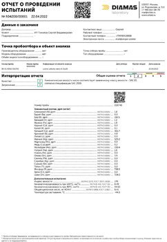

Элементный состав, ppm (мг/кг)
Алюминий (Al), ppm /ASTM D 6595/ .................................................................................. 1.8
Барий (Ba), ppm /ASTM D 6595/ ........................................................................................... 0.0
Бор (B), ppm /ASTM D 6595/ .................................................................................................. 118.5
Ванадий (V), ppm /ASTM D 6595/ ........................................................................................ 1.2
Железо (Fe), ppm /ASTM D 6595/ ........................................................................................ 1.9
Кадмий (Cd), ppm /ASTM D 6595/ ....................................................................................... 0.0
Калий (K), ppm /ASTM D 6595/ ............................................................................................. 0.1
Кальций (Ca), ppm /ASTM D 6595/ ...................................................................................... 301.7
Кремний (Si), ppm /ASTM D 6595/ ...................................................................................... 4.8
Литий (Li), ppm /ASTM D 6595/ ............................................................................................ 0.0
Магний (Mg), ppm /ASTM D 6595/ ....................................................................................... 529.2
Марганец (Mn), ppm /ASTM D 6595/ .................................................................................. 0.0
Медь (Cu), ppm /ASTM D 6595/ ............................................................................................ 0.2
Молибден (Mo), ppm /ASTM D 6595/ ................................................................................. 150.4
Натрий (Na), ppm /ASTM D 6595/ ....................................................................................... 1.6
Никель (Ni), ppm /ASTM D 6595/ ......................................................................................... 0.0
Олово (Sn), ppm /ASTM D 6595/ .......................................................................................... 3.9
Свинец (Pb), ppm /ASTM D 6595/ ....................................................................................... 0.0
Серебро (Ag), ppm /ASTM D 6595/ ..................................................................................... 0.0
Сурьма (Sb), ppm /ASTM D 6595/ ........................................................................................ 0.0
Титан (Ti), ppm /ASTM D 6595/ ............................................................................................ 0.0
Фосфор (P), ppm /ASTM D 6595/ ......................................................................................... 738.5
Хром (Cr), ppm /ASTM D 6595/ ............................................................................................. 0.0
Цинк (Zn), ppm /ASTM D 6595/ ............................................................................................ 724.0
Дополнительные испытания
Индекс вязкости /ASTM D 2270, ГОСТ 25371-2018/ ......................................................... 170
Кинематическая вязкость при 100°С, мм²/с /ASTM D 445, ГОСТ 33/ .................... 8.49
Кинематическая вязкость при 40°С, мм²/с /ASTM D 445, ГОСТ 33/ ...................... 44.63
Общее щелочное число, мг КОН/г /ASTM D 2896, ГОСТ 11362/ ............................... 9,41
Температура застывания, °C ........................................................................-44,6

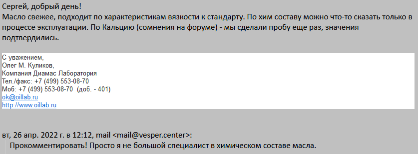

по вязкости нормально, похоже на 0W-20. Но вот по пакету присадок трэш какой-то... Не бывает такого что бы кальций 300ppm, магний 500ppm. Может кальция 1300?
Лаборатория точно элементы присадок определила?  Фосфора цинка нормально.
Уточню у специалистов завтра

надо разобраться с кальцием в масле, либо это завод такое масло замешал, либо лаба так протестировала, но столько кальция не бывает. Это не ACEA C4...

Врятли щелочное число из анализа вы наберёте этими элементами,что намерила лаба
