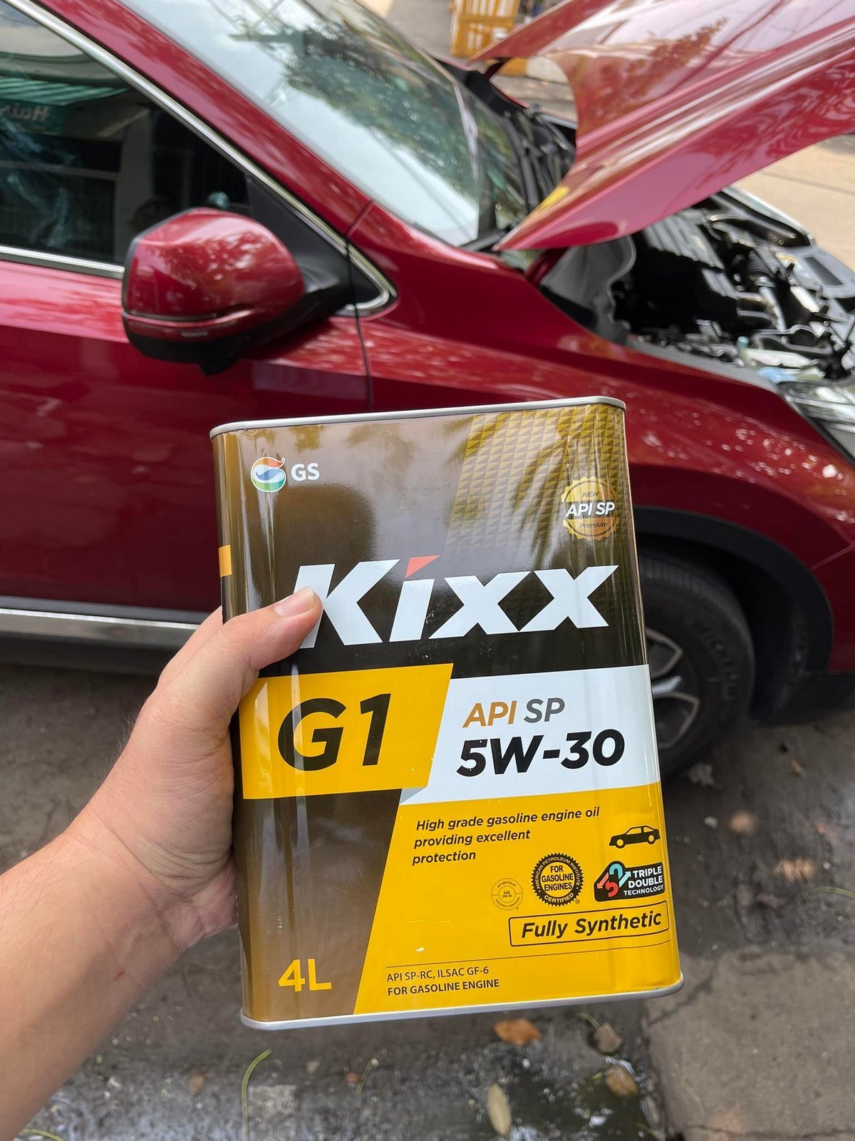

Здравствуйте! Подскажите пожалуйста на солярис 2021г.в, объем 1.6, подойдёт масло этой марки? Если да, то какое?
Hi, I have a Honda CRV 1.5Turbo. I'm looking at the KIXX 5w-30. KiXX SP or Dexos1Gen2 is more suitable. Thank you.
22.03.2022 в 19:04, Fildep сказал:
Fildep , добрый день!
Hyundai Solaris 2021 года, комплектуется в том числе двигателем 1.6 типа G4FG. Сложных требований к подбору масел не предъявляет - уровень требований API SM (ILSAC GF-4) или выше. То есть то, что выше - это уровень спецификаций API SN, SN Plus, SP.
Что подойдет:
1. Kixx G1 SP 5W-30 (API SP, ILSAC GF-6A)
2. Kixx G1 SN Plus 5W-20 (API SN Plus, ILSAC GF-5)
3. Kixx G1 Dexos1 5W-30 (API SN Plus, ILSAC GF-5, GM Dexos1 gen.2)
4. Kixx PAO1 0W-30 (API SN, ACEA A5/B5/C2)
и еще несколько видов.
Изменено пользователем KIXX
22.03.2022 в 20:17, free2d сказал:
Good Day,free2d !
According to the manual, the Honda CR-V 1.5 Turbo requires an engine oil that meets API specifications, category SM or higher, with a viscosity of 0W-20, 0W-30, 5W-30, 10W-30.
Therefore, these 2 types of engine oil can be used to service the engine:
2. Kixx G1 Dexos1 5W-30 (API SN Plus, ILSAC GF-5, GM Dexos1 gen.2)
338692518_KixxG1SP5W-30220131.thumb.jpg.07a113598215ebe8c3f0bde9eb5ba643.jpg 1665035653_KixxG1Dexos15W-30220306.thumb.JPG.48d4232f996277a8db6d7ec3e07be24c.JPG

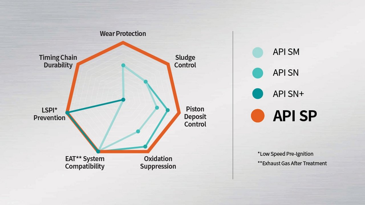

2 часа назад, free2d сказал:
Which is a better product if can choose one? API vs Dexos1? I heard Dexos is more strick than API and ILSAC.
Good Day,free2d!
The relevance of the specifications of GM Dexos1 is mainly important for Chevrolet and GMC vehicles. At the same time, the API SP specification is considered the most modern for all gasoline engines of Japanese and American car brands.
In our opinion, it is better for you to use Kixx G1 SP 5W-30.
We invite you to look at these images, and also read the text at the link
https://news.kixxoil.com/kixx-launches-new-line-of-engine-oils-to-meet-api-sp-specification/
1462782689_UpdateAPI(ILSAC)specificationforengineoil.thumb.jpg.b4f8444bc73ca0eb61e1b321d47057fd.jpg newsroom_0803_sub-1.thumb.jpg.7c396e61688b25d3ecb4c993fa3e30f8.jpg

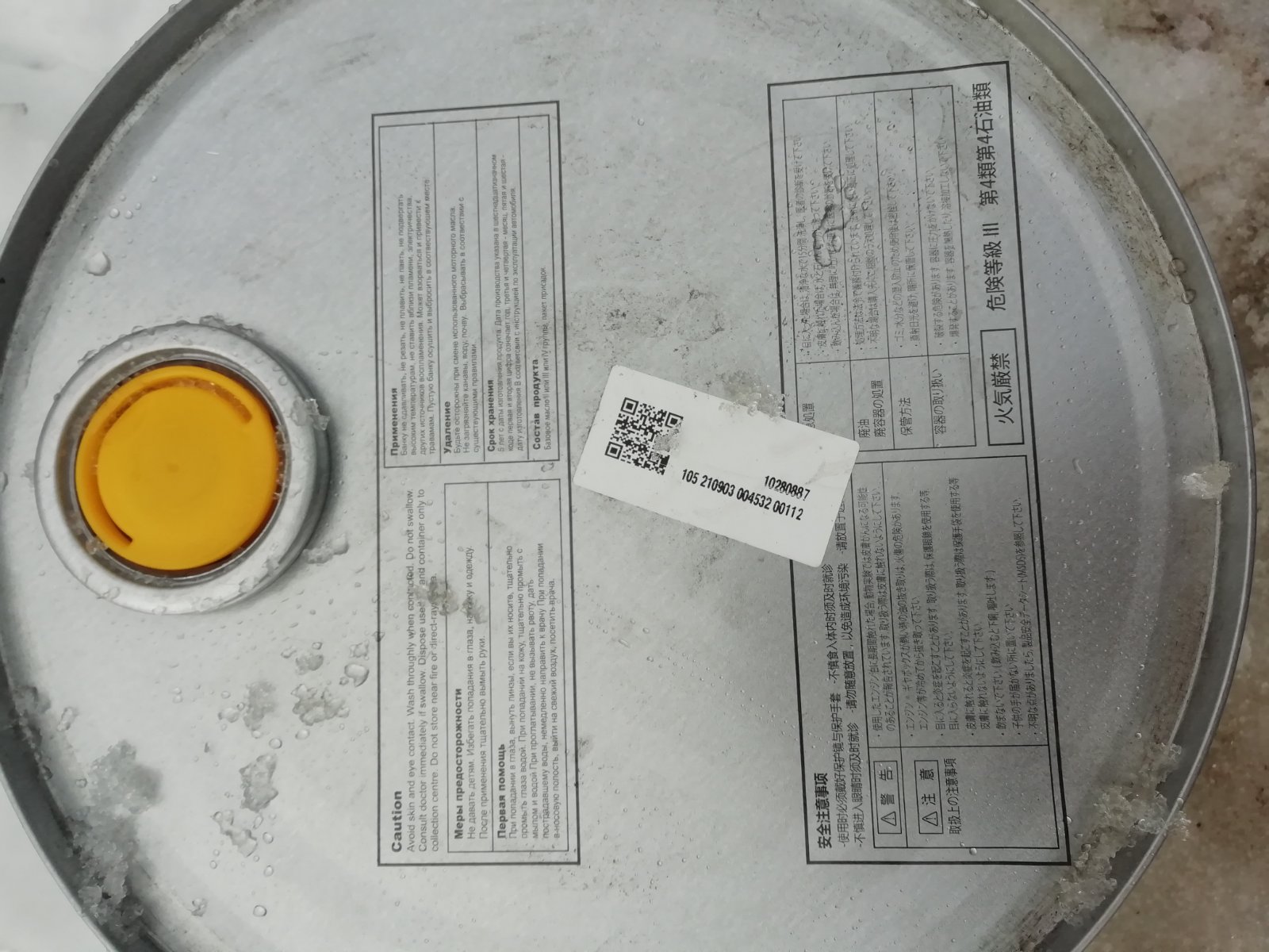

Добрый день. Купил  20 л. В G4NA Кикса, почему то нет надписи ilsac gf5? Что это, левак?), фото выше
Изменено пользователем Denver 76
25 минут назад, Denver 76 сказал:
Denver 76 , добрый день!
Указание на спецификацию ILSAC GF-5 исчезло после 1 мая 2021 года, потому что годом ранее вышло обновление ILSAC GF-6. А именно у этого сорта масла рецептура не менялась, т.е по факту состав тот же что и был с надписью GF-5. Это просто требование сертификации, ILSAC, который сейчас разрешает размещать символ и надпись только на новый стандарт GF-6.
Канистры Kixx G1 SN Plus 5W-30, 20 литров - все оригинальные. На канистре, которую вы приобрели указан срок изготовления масла 210903 (мы выделили на Вашем фото) - что означает 21 год 09 месяц (сентябрь), 03 день (число). Всё абсолютно нормально, мы в этом уверены!
