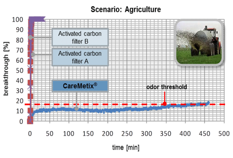

The performance of CareMetix is vastly superior to all solutions that have been previously offered in this area. The innovation lies the completely new adsorber, which in addition to gas adsorption, eliminates odours of all types and intensity,” explains Olaf Henning, Member of the Management Committee and Managing Director of MAHLE Aftermarket GmbH. “Numerous test persons have confirmed from the experience that there is currently no comparable product available in the market.”
The selected media, surface finish, and pleat geometry are crucial to the performance of cabin filters with activated carbon and adsorber layer. The MAHLE CareMetix cabin filter represents the ideally coordinated combination of five specialised layers that significantly optimise the effectiveness of the filter and expand the filter spectrum for the first time in such a way that it even eliminates odours. Independent institutes have also confirmed the bio-functional effect of the innovative filter element, namely the protection from microorganisms and allergens.
The combination of a high-performance particulate filter layer, a molecular sieve layer, two different activated carbon layers for the adsorption of organic and inorganic gases, and an additional protective coating comprehensively thwarts the incoming solid matter and gas particles already before they can enter the cabin.
Allergens, as they occur annually in spring in the form of pollen, are effectively blocked and deactivated.
Brake dust, diesel soot, fine particulates, and tyre debris, which are further transported by exhaust fumes from the preceding traffic, are completely filtered out. As a result, the cabin remains almost free from the smallest particulates (PM 2.5). In addition, sensitive components of the air conditioning system are protected from wear.
Micro-organisms such as bacteria are prevented from spreading—even on the filter medium itself.
The same applies to moulds and spores, which spread rapidly during humid and warm weather. They are kept out of the vehicle and have no opportunity to collect on the filter medium.
In addition to gas adsorption, what makes MAHLE CareMetix a worldwide novelty is its ability to eliminate odours of all types and intensity. Be it in a traffic jam, tunnels, at large construction sites, or near water treatment plants or agricultural facilities: CareMetix protects from unpleasant, pungent odours such as tar vapours as well as sulphur and ammonia gases by completely neutralising them. This has been demonstrated not only in the laboratory, but also by comprehensive stress tests in everyday driving situations.
Один график все же нашел:
Изменено пользователем IliaP.
