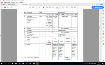

In case G12++ may contain 2-EHA solid (see MSDS/SDS data).
VAG TL 774 does not contain any info about 2-EHA.

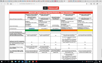

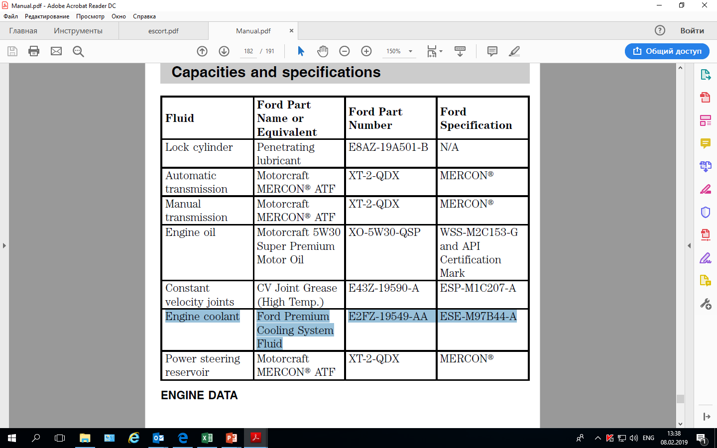

Motorcraft® Premium Prediluted Antifreeze/Coolant (USA) for FORD Pre-1999 - has Ford Spec. ESE-M97B44-A same as Havoline XLC.
image.thumb.png.6900a23cf8d3dfce39ceb2da56f817a7.pngimage.thumb.png.053f267ce8844f4a6c1234f793906a40.png
It seems that OAT in 1988 - not big problem.
