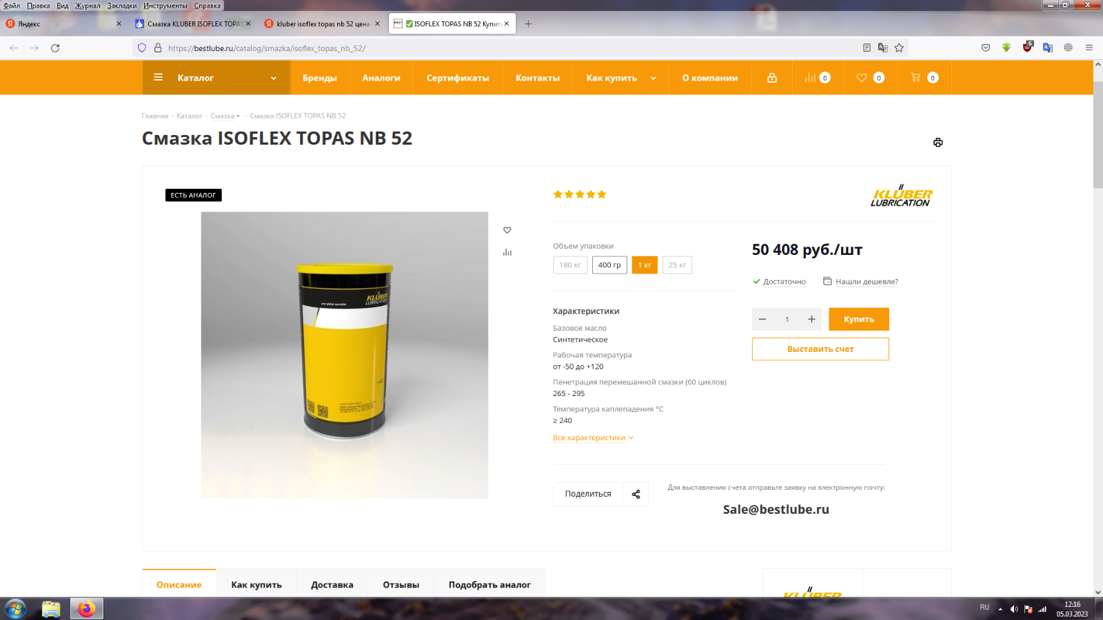

Cмазка KLUBER ISOFLEX TOPAS NB 52
ISOFLEX TOPAS NB 52
Chemical composition, thickener: barium complex soap
Chemical composition, type of oil: synthetic hydrocarbon oil
Lower service temperature: -50 °C
Upper service temperature: 120 °C
Colour space: beige
Texture: homogeneous
Texture: short-fibred
Density at 20 °C approx.: 0.96 g/cm³
Worked penetration, DIN ISO 2137, 25 °C, lower limit value: 265 x 0.1 mm
Worked penetration, DIN ISO 2137, 25 °C, upper limit value: 295 x 0.1 mm
Shear viscosity at 25 °C, shear rate 300 s-1, equipment(rotational viscometer, lower limit value): 4 000 mPas
Shear viscosity at 25 °C, shear rate 300 s-1, equipment(rotational viscometer, upper limit value): 8 000 mPas
Kinematic viscosity, DIN 51562 pt. 01/ASTM D-445/ASTM D7042, 100 °C: approx. 5.9 mm²/s
Kinematic viscosity of the base oil, DIN 51562 pt. 01/ASTM D-445/ASTM D 7042, 40 °C: approx. 30 mm²/s
Corrosion inhibiting properties of lubricating greases, DIN 51802,(SKF-EMCOR), test duration, 1 week, distilled water: 0 corrosion degree
Copper corrosion, DIN 51811, (lubricating grease), 24h/100 °C: 1 - 100 corrosion degree
Oil separation, ASTM D 6184 [FTMS 791 C 321], after 30 h/100 °C: <= 3 % by weight
Drop point, DIN ISO 2176: >= 240 °C
Oxidation stability of lubricating greases, DIN 51808, 100 h/99°C, pressure drop: <= 0.3 bar Speed factor (n x dm): approx. 1 000 000 mm/min
Water resistance, DIN 51807 pt. 01, 3 h/90 °C, rating: <= 1 - 90
Minimum shelf life from the date of manufacture - in a dry, frost-free place and in the unopened original container, approx.: 36 months
