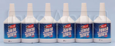

нашёл наконец что за масло пиарили в спортивных программах по телику в америке!
Red Line 5W30 Synthetic Motor Oil - Case 12 Quarts
As low as $8.99
Description: The synthetic base stocks used by RedLine have a natural multigrade property so they do not require large amounts of unstable polymeric thickeners as used in multigrade petroleum oils. The superior high-temperature stability makes these oils ideal for use in turbocharged, air-cooled, and other hot-running applications all the way up to jet engines! RedLine oils also feature more ZDDP than other street oils, which makes them ideal for use in solid-lifter and flat-tappet engines. For normal street use, RedLine recommends oil changes every 12-18,000 miles for gasoline engines, or at least once per year. Viscosity recommendations:5W30 provides the best lubrication on start-up and reduces turbo lag. Best choice for maximum power and economy.
5W40 provides more power and economy than a petroleum 5W40 or 10W40, while providing 25% thicker oil films.
10W30 provides excellent economy and power while providing thicker oil films than a petroleum 10W40 oil.
10W40 is the best all-weather viscosity. Oil film thicknesses exceed that of 20W50 petroleum oils when hot but flow much better when cold. 1
5W50 and 20W50 offer the ultimate protection at high temperatures and are especially recommended in air-cooled and Mazda rotary engines.
15W40 Diesel Engine Oil is highly resistant to thermal breakdown and provides double the detergent and acid neutralizing ability of petroleum oils.
