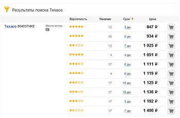

804037NKE - Texaco Havoline ProDS P 0W-30 (12x1LP2) TX
804037DEE - Texaco Havoline ProDS P 0W-30 (208L M) TX
804037HOE - Texaco Havoline ProDS P 0W-30 (20LP) TX
804037MHE - Texaco Havoline ProDS P 0W-30 (4x4LP2) TX
804037CXE - Texaco Havoline ProDS P 0W-30 (60LM ) TX
