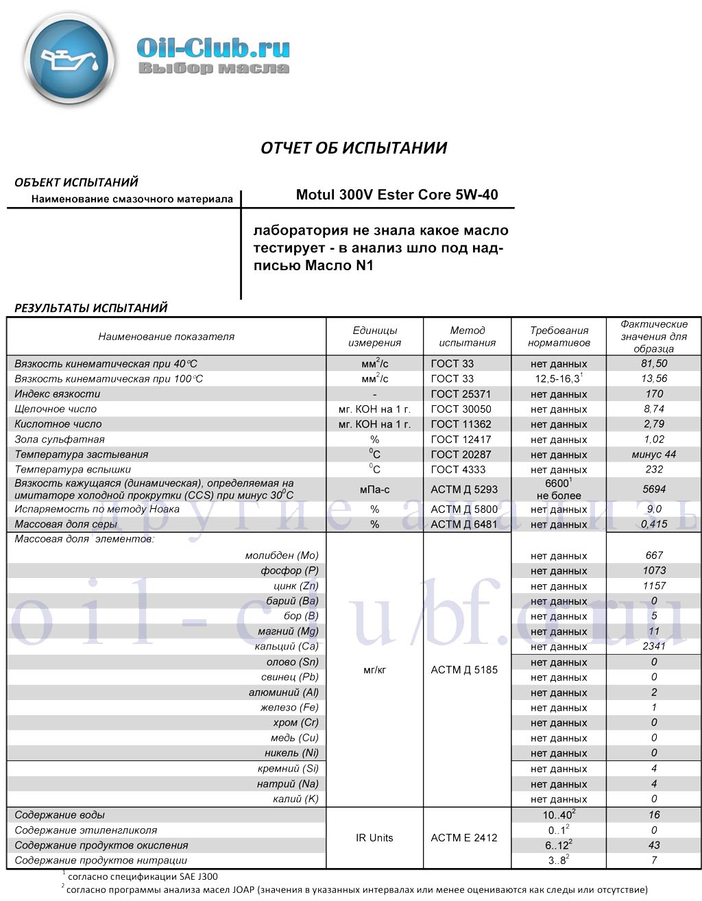

Millers-Oils-CFS-5W-40-NT-_VOA-BASE_.jpgMobil1-Racing-0W-30-_VOA-BASE_.jpgRedline-5W-40-_VOA-BASE_.jpgMotul-300V-5W-40-Ester-Core.jpg
