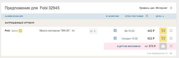

32945 - Febi     5W-30 Longlife Plus    1
32946 - Febi     5W-30 Longlife Plus    4
32947 - Febi     5W-30 Longlife Plus    5
32948 - Febi     5W-30 Longlife Plus    60
39337 - Febi     5W-30 Longlife Plus    200
