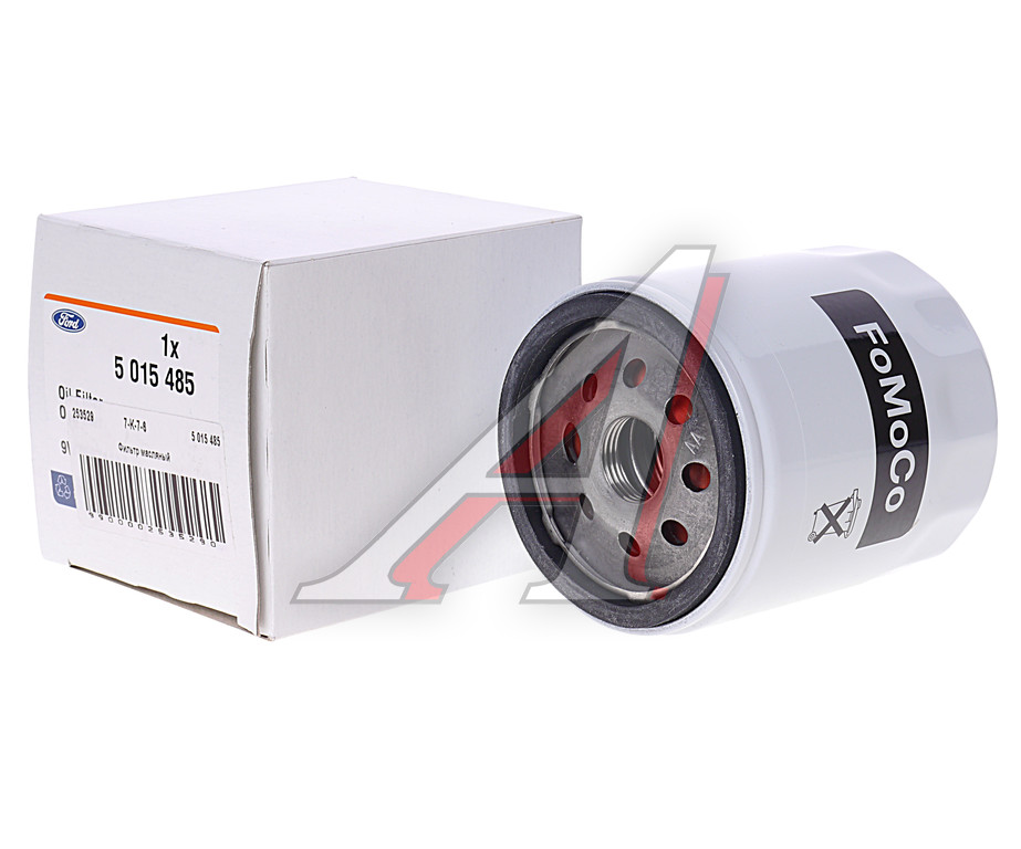

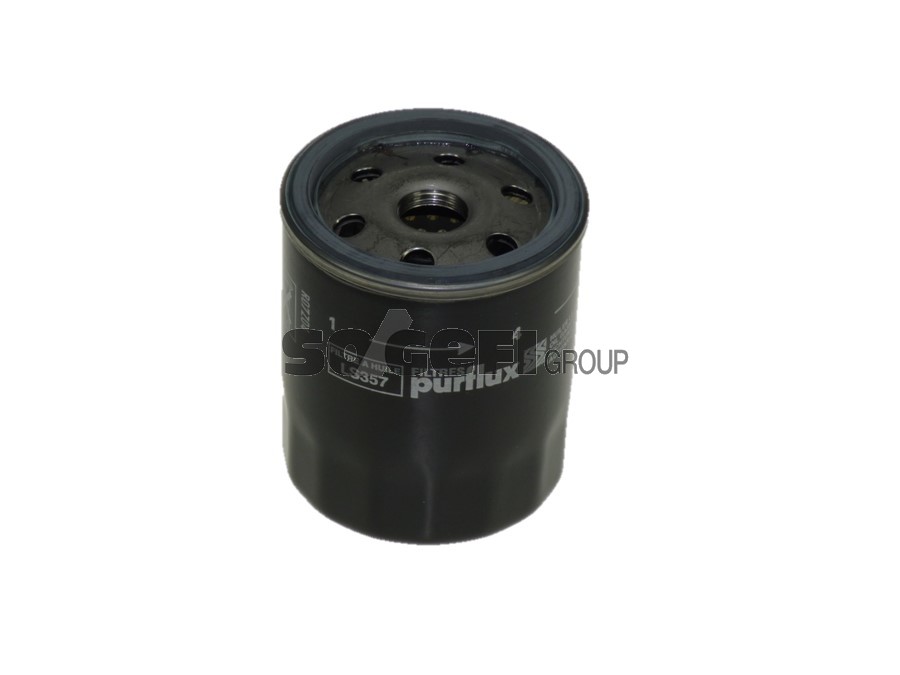

FORD 5015485 (Sogefi Group) = PURFLUX LS357 = FRAM PH9566 = COOPERSFIAAM FT5754
post-5730-0-47953700-1452603292_thumb.jpgpost-5730-0-89381000-1452603292_thumb.jpgpost-5730-0-65527900-1452603293_thumb.jpgpost-5730-0-28992100-1452603294_thumb.jpg
