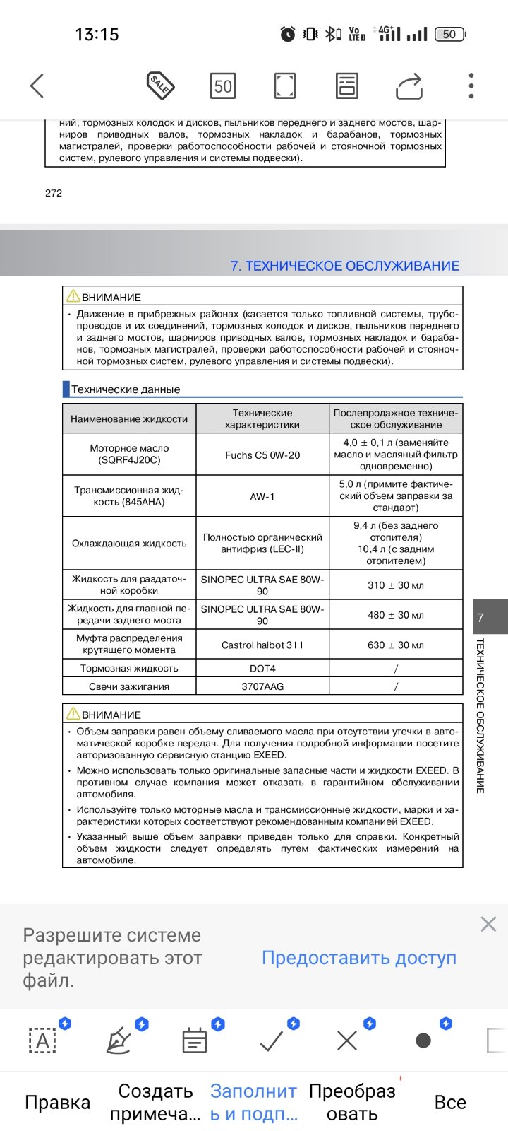

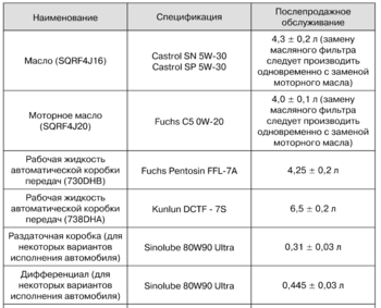

Мануал по машине показывает вот такую табличку

Вот что пишут в спецификации
Sinopec GL-5 80W90 Heavy Duty Automotive Gear Oil Specifications SAE grade  80W-90
Kinematic viscosity, ASTM D 445  cSt @ 100°C     16.93   Viscosity index, ASTM D 2270  106 Copper corrosion, 3 hours @ 121°C, ASTM D 130  1b  Pour point, °C, ASTM D 97  -30 Flash point (COC), °C, ASTM D 92  208 Density @ 15°C, kg/l, ASTM D 4052  0.884  Sinopec GL-5 80W90 Heavy Duty Automotive Gear Oil meets or exceeds the performance requirements of the following industry specifications: API  GL-5 GB1    11122-2006 (CI-4)
MIL  L-2105D
Sinopec GL-5 80W90 Heavy Duty Automotive Gear Oil meets or exceeds the performance requirements of the following OEM specifications:
Муфта BorgWarner шестого поколения
Изменено пользователем hugee13
