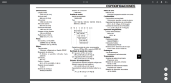

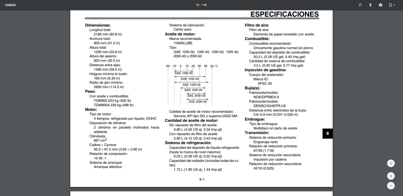

9) В мануале следующие рекомендации:
API standard SE or higher grade ACEA standard G4 or G5
Так же предостережение по мокрому сцеплению
Engine oil also lubricates the clutch and
the wrong oil types or additives could
cause clutch slippage. Therefore, do not
add any chemical additives or use engine
oils with a grade of CD or higher and do
not use oils labeled “ENERGY CONSERV
ING II” b or higher.
на Yamaha TDM900 API SG и выше, и JASO MA

21 час назад, st0nx сказал:
Yamaha TDM 900 2002
Specifications*:
Engine size:
897
Cylinders:
2
hp/kW:
86/63
Vehicle weight (kg):
223
Seat height (mm):
825
Valve clearance (intake):
KALT 0,15-0,20 MM
Valve clearance (exhaust):
KALT 0,23-0,28 MM
Engine idle speed:
1100-1200 U/MIN
Carburettor air screw:
EINSPRITZUNG
Tyre pressure (front):
2,5 BAR
Tyre pressure (rear):
2,5 (2,9 BAR)
Spark plug 1:
NGK DPR8EA-9
Spark plug 2:
NGK DPR8EIX-9
Electrode gap:
0,9 MM
Fork tube diam.:
43 MM TELEGABEL
Front/rear sprockets:
16/42 ZÄHNE
Chain/Final drive:
118 GLIEDER
Capacities*:
Fork oil per rod:
507 ML SAE 10W
Engine oil w/o filter:
3,8 L SAE 10W-40
Engine oil with filter:
3,9 L MIN. API SE
Brake fluid:
DOT 4
Fuel:
20,0 LITER
Coolant:
1,7 LITER
То есть можно использовать авто масла без модификаторов трения SAE 10w-40 API SE, SF, SG.
