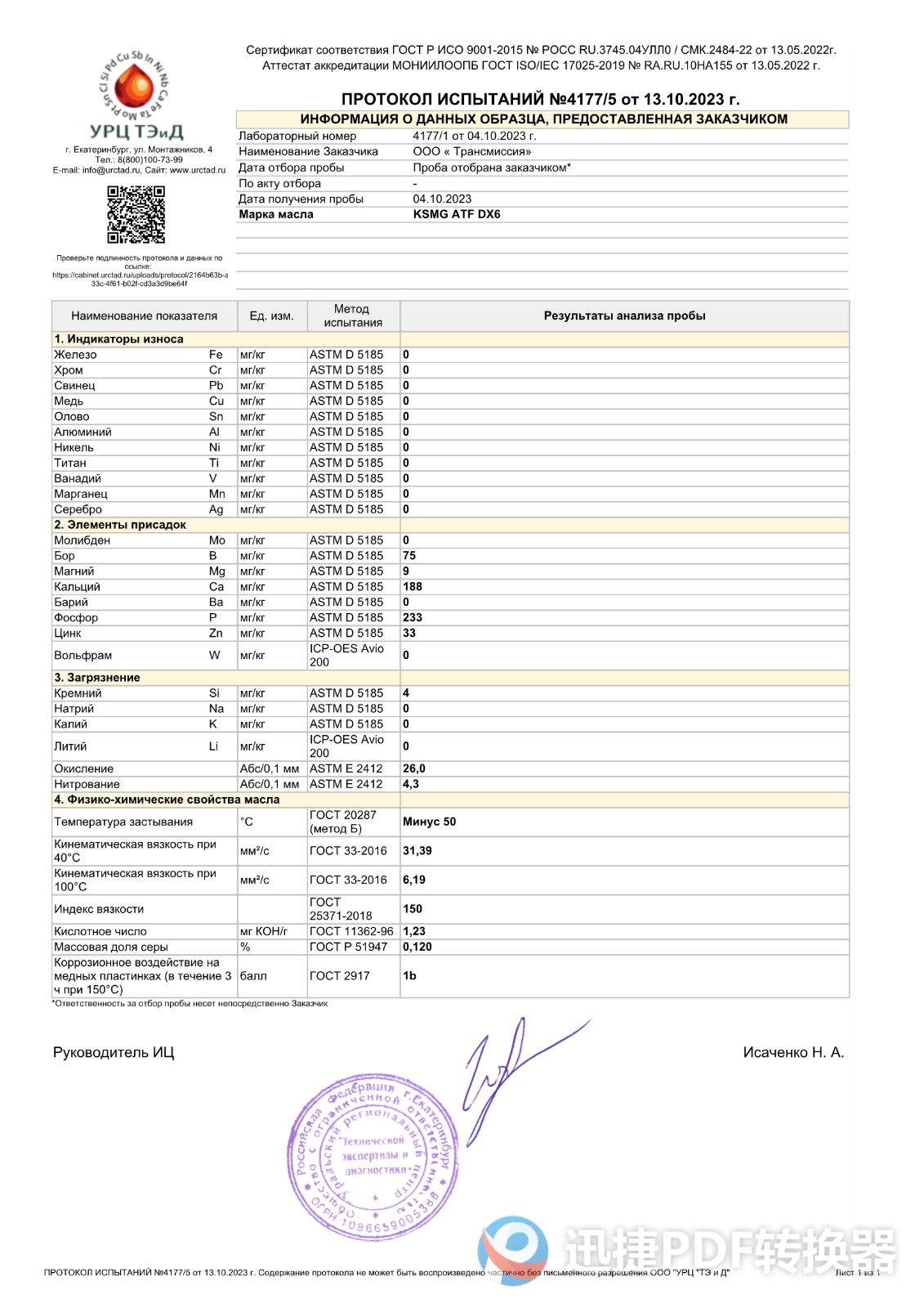

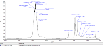

KSMG ATF DX6 свежее Бельгия
Масло заявлено как:
GM Dexron VI / IIIH, AisinWarner JWS 3309/ 3324/ AW-1/ AW-2, BMW 7045E/8072B/LA2634/ATF6, Chrysler Dodge Mopar AS68RC/69RC, Ford Mercon LV/ Mercon/ M2C138-CJ, Ford M2C166-H/ 922-A1/ 924-A/ 938-A, VW G 055 162 / G 055 540 / G 060 162, Subaru ATF ATF/ AW-1/ 5AT/ ATF HP, Suzuki ATF 3309/ 3314/ 3317/ 2326/ 2384К, VOLVO 97335/ 97340/ 1161540, Honda Acura DW-1/ATF-Z1(except in CVT), Mazda ATF DII/ M-III/ M-V/ FZ/ F-1/ S-1/ N-1/ 3317, Hyundai/Kia SP-II/ SP-III/ SP-IV/ SP-IV M/ SP-IV RR, Daihatsu ATF D-II/D-III SP, MB 236.1/ 2/ 3/ 236.5/ 236.7/ 236.8/ 236.9/ 236.41, Mitsubishi SK/SP-II/SP-III/SP-IV/AW/ J2/ J3/ PA/MA1, VW G 052 025 / G 052 055 / G 052 162 / G 052 990, VW G 053 001 / G 053 025 / G 055 005 / G 055 025, Nissan Matic C/ D/ J/ K/ P/ S/ W, ZF 5HP 18FL/19FL/24A/30/4HP20, ML05L/09/11A/ B/ 21L, Toyota D-II/ D-III/ T-III/ T-IV/ WS, Chrysler ATF+/+2/+3, Allison C3/C4, PSA B71 2340, Cat TO-2, Fiat Type IV, Isuzu ATF II/ III/ SP, Jaguar ATF 3403 M115, Porsche 3403-M115.
P41141-KSM020 - KSMG ATF DX6 (GM Dexron VI , Бельгия), 20 л.
P41141-KSM004 -    KSMG ATF DX6 (GM Dexron VI , Бельгия), 4 л.
