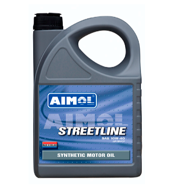

Aimol Streetline 10W-40 (API: SN/CF; ACEA: A3/B4; MB 229.1; VW 500.00/505.00)
Спецификации: API: SN/CF; ACEA: A3/B4; MB 229.1; VW 500.00/505.00; Fiat: 9.55535-G.

AIMOL Streetline 10W-40 1 л - AST15L1
AIMOL Streetline 10W-40 4 л - AST15L4
AIMOL Streetline 10W-40 20 л - AST15L20
AIMOL Streetline 10W-40 60 л - AST15L60
AIMOL Streetline 10W-40 205 л - AST15L205
