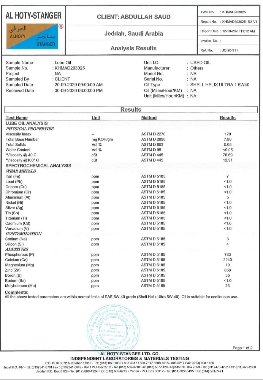

1 минуту назад, Dimmy сказал:
As for Molybdenum. Actually, I think there should be no Mo in this Ultra I 5W-40. But in your UOA there is some, though twice lower than might be expected. Qiute strange. I don't know what to think. If you are absolutely sure that the previous oil was also Ultra I and the UOA is the same oil that your VOA - then it may be explained by the presence of Mo in Ultra I 5W-40. But why the Lab did not see Mo in the VOA and did it in UOA? The Lab is the same, isn't it?
I'm not 100% sure about the previous oil could be the Mo is residue from previous oil changes.
Yes both Analyzes from the same laboratory.
Before a year or so I used an oil with a minimum 55ppm of Mo.
37 минут назад, Abadi55z сказал:
To get 23 ppm of Mo from the previous oil the latter should have had about 300-500 ppm.
31 минуту назад, Dimmy сказал:
Oh that's a lot

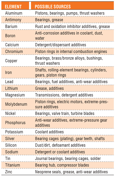

Then it could be an indication of piston ring wear out?
According to this table from Machinery Lubrication.
13 часов назад, Abadi55z сказал:
Чтобы столько молибдена настрогало с колец или ещё чего, где он находится как легирующая присадка измеряющаяся в единицах или долях процента, надо, чтобы основного металла было гораздо больше. Но его нет.
Этот молибден из масла.
Хороший анализ. Масло в норме. Двигатель в норме. Тихо завидую.
14 минут назад, Texacoman сказал:
