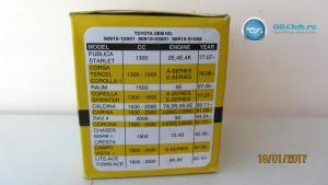

Применяемость:
Toyota 1000, KP36
Toyota Allex, NZE121, NZE124, ZZE122
Toyota Allion, ZZT245, NZT260, ZZT240, NZT240
Toyota Altezza, SXE10
Toyota Aqua, NHP10
Toyota Auris, NZE154, ZRE151, NZE151, ZZE150, NZE184, NZE181
Toyota Avensis, ST220, ZZT251, ZZT221, ZZT220, AT220, ZZT250, AT221
Toyota Aygo, KGB10
Toyota Belta, SCP92, NCP96
Toyota Caldina, ST215, ET196, ST190, AT211, ST191, ST195, ZZT241, AT191, ST198, ST210
Toyota Camry Gracia, SXV25, SXV20
Toyota Camry, SV41, SV32, SV42, SV20, SV22, SXV20, SXV10, SXV11, SXV23, SV30, SV40, SV43, SV21, SV33, SV25, SV35
Toyota Carina E, AT191, AT190, ST191
Toyota Carina ED, ST202, ST201, ST203, ST200, ST183, ST182, ST160, ST163, ST162, ST181, ST180, ST205
Toyota Carina II, AT177, ST171, ST151, ST150, AT171, AT151
Toyota Carina, AT175, AT212, ET176, AT190, ST195, AT170, AT192, AT160, AT150, ST190, AT211, ST170, ST150, AA60, ST215, ST162, AT191, AT171, AT151, SA60
Toyota Celica, ZZT230, AT200, ST184, ST162, ST160, ST182, AT160, AT180, ST202, ST204, ST185
Toyota Chaser, SX80, SX90, SX70, SX100
Toyota Corolla Axio, NKE165, NZE161, NZE164, NZE141, NZE144
Toyota Corolla Ceres, AE100, AE101
Toyota Corolla FX, AE82
Toyota Corolla Fielder, NZE124, ZZE124, ZZE122, NKE165, NZE141, NZE161, NZE144, NZE120, NZE164, NZE121
Toyota Corolla II, EL30, EL41, EL51, EL43, EL31, EL53, EL45, EL55
Toyota Corolla Levin, AE100, AE111, AE101, AE92, AE91, AE110
Toyota Corolla Rumion, NZE151
Toyota Corolla Runx, NZE121, NZE124, ZZE122
Toyota Corolla Spacio, AE111, ZZE124, NZE121, ZZE122, AE115
Toyota Corolla Sprinter, AE102
Toyota Corolla Verso, ZNR10, ZNR11, ZZE122, ZZE121
Toyota Corolla, AE114, EE90, AE102, AE110, AE92, ZZE120, ZZE132, ZZE112, EE105, EE98, EE101, AE103, AE115, EE108, ZRE151, AE111, ZZE150, AE91, AE71, ZZE111, EE104, AE95, KE70, EE97, EE100, AE104, EE107, AE112, AE100, ZZE130, AE82, ZZE110, EE103, EE80, AE86, EE96, EE111, AE109, AE101, ZZE121, EE106, EE102, EE110
Toyota Corona Exiv, ST183, ST181, ST182, ST180, ST201, ST200, ST203, ST202, ST205
Toyota Corona, AT150, ST220, AT170, ST151, ST195, ST163, AT190, ST150, ST170, ST190, AT211, ST215, ST162, AT177, AT210, AT140, ST210, ST160, ET176, AT151, AT171, ST140, ST171, ST191, AT220, AT175
Toyota Corsa, AL21, AL20, AL25, EL43, EL55, EL45, EL51, EL30, EL41, EL31, EL53
Toyota Cresta, SX90, SX80, SX70
Toyota Crown, SXS11, SXS13
Toyota Curren, ST207, ST206, ST208
Toyota Cynos, EL44, EL54, EL52
Toyota Deliboy, KXC10
Toyota Echo Verso, NCP20, NCP21, NCP22
Toyota Echo, SCP10, NCP12, NCP10, NCP11
Toyota Funcargo, NCP20, NCP25, NCP21
Toyota Gaia, SXM10, SXM15
Toyota Harrier, SXU15, SXU10
Toyota Ipsum, SXM10, SXM15
Toyota Isis, ZNM10
Toyota Lite Ace Noah, SR40, KR41
Toyota Lite Ace, KM37, KR27, SR40, KM36, KM35, KM30, KM51, KM31, KM20, KM50, KR21
Toyota MR-S, ZZW30
Toyota MR2, AW11, AW10, SW21, SW20, ZZW30
Toyota Mark II Wagon Qualis, SXV25, SXV20
Toyota Mark II, SX70, SX80, SX90
Toyota Masterace, KR26, KR27
Toyota Matrix, ZZE132, ZZE130
Toyota Nadia, SXN10, SXN15
Toyota Opa, ZCT10, ZCT15
Toyota Paseo, EL44, EL54
Toyota Picnic, SXM10
Toyota Platz, SCP11, NCP12, NCP16
Toyota Porte, NCP145, NNP10, NNP11, NCP141, NNP15
Toyota Premio, NZT260, ZZT240, NZT240, ZZT245
Toyota Prius, NHW11, NHW20, NHW10
Toyota Probox, NCP51, NCP50, NCP52, NCP55, NCP59, NCP58
Toyota RAV4, ZCA25, ZCA26, SXA11, SXA10, SXA16, SXA15
Toyota Ractis, NCP100, NCP122, NCP120, NCP105, NCP125, SCP100
Toyota Raum, NCZ25, EXZ15, NCZ20, EXZ10
Toyota Scepter, SXV15, SXV10
Toyota Sera, EXY10
Toyota Sienta, NCP85, NCP81
Toyota Solara, SXV20
Toyota Soluna, AL50
Toyota Spade, NCP145, NCP141
Toyota Sprinter Carib, AL25, AE95, AE114, AE115, AE111
Toyota Sprinter Marino, AE101, AE100
Toyota Sprinter Trueno, AE111, AE100, AE110, AE101, AE92, AE91
Toyota Sprinter, EE102, EE108, EE106, AE101, AE111, AE109, AE91, AE95, EE103, EE101, EE107, AE104, AE100, AE110, EE96, EE98, AE92, EE90, EE111, EE80
Toyota Starlet, KP60, EP76, EP82, EP70, EP91, KP61, EP85, EP95, EP71, EP81, EP80, EP90, KP60V, KP61V
Toyota Succeed, NCP50, NCP51, NCP55, NCP52, NCP58, NCP59
Toyota Tercel, AL21, EL42, EL30, EL40, EL50, AL20, EL53, EL31, EL41, EL51, EL45, EL55, EL43, AL25
Toyota Town Ace Noah, SR40, SR50, KR41
Toyota Town Ace, KM36, KR27, SR40, KR26, KM35, KM50, KM51, KM30, KM31
Toyota Vista Ardeo, SV50, SV55, ZZV50
Toyota Vista, SV50, SV40, SV41, SV30, ZZV50, SV35, SV25, SV42, SV20, SV21, SV43, SV32, SV22, SV33, SV55
Toyota Vitz, NCP131, SCP10, SCP13, NCP10, NCP13, NCP15, NCP91, NCP95, SCP90
Toyota Voltz, ZZE138, ZZE136
Toyota WiLL Cypha, NCP75, NCP70
Toyota WiLL VS, ZZE129, ZZE127, NZE127
Toyota WiLL Vi, NCP19
Toyota Wish, ZNE10, ZNE14
Toyota Yaris Verso, NCP20, NCP22, NCP21
Toyota Yaris, SCP90, SCP10, NCP11, NCP12, NCP10
Toyota bB, NCP35, NCP30, NCP34, NCP31
Toyota ist, NCP65, NCP110, NCP115, NCP61, NCP60

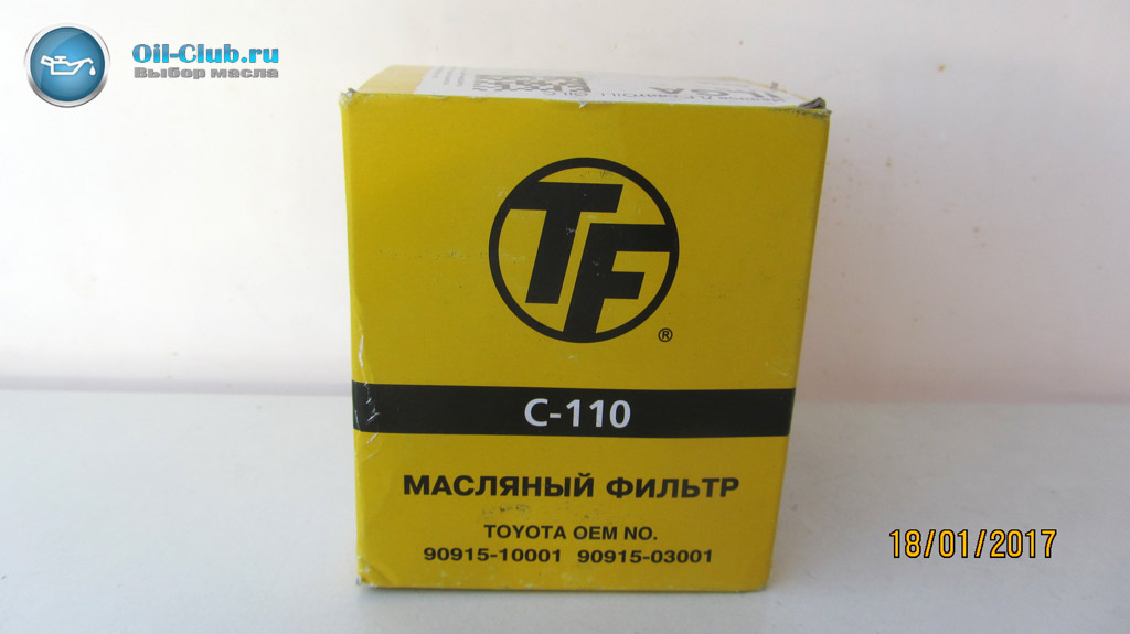

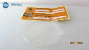

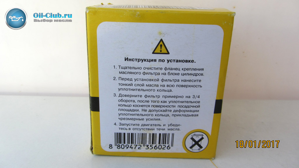

Простая но информативная коробка, есть применяемость, есть оригинальные номера, указана страна производства Made in Korea, есть пленочка на горловине фильтра, есть наклеечка-памятка что бы ничего не забыть. Хочу за это похвалить.

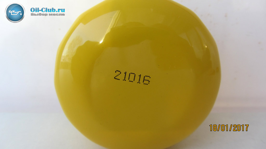

Корпус фильтра окрашен в желтый цвет, есть дата производства, внутри немного брызг краски.

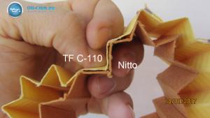

А вот тут меня клинануло и разрезал фильтрующую катушку не показав вам ее. Но она есть в видеоролике - посмотрите там. В общем передам устно. Фильтрующий материал уложен часто, но он тонкий бюджетный... Опасных капель герметика нет. Катушка занимает максимум пространства в корпусе фильтра.

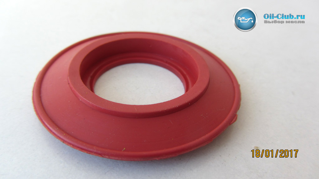

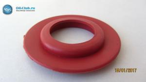

Противодренажный клапан - минус этого фильтра. Клапан резиновый, толстый лепесток, ввиду этого не эластичен. По кругу имеет облой.

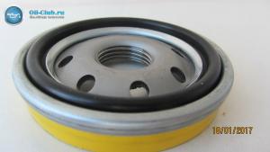

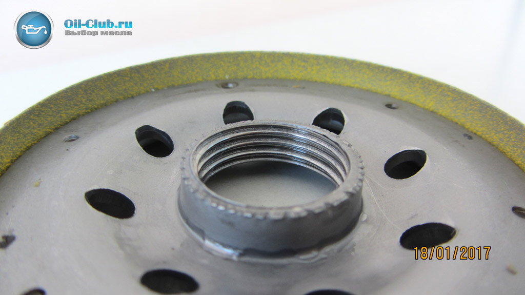

Резьба нарезана чисто, заусенцы с торца есть но они не выпирают.  Уплотнительное кольцо круглого сечения - мягкое, впечатление будто наполнено силиконом - гладкая на ощупь. В общем в морозы побежать это кольцо не должно (точнее скажет практика его использования).

Фильтрующий материал TF С-110 тонкий, бюджетный
Длинна фильтровальной шторы 134см - для маленького фильтра не мало...

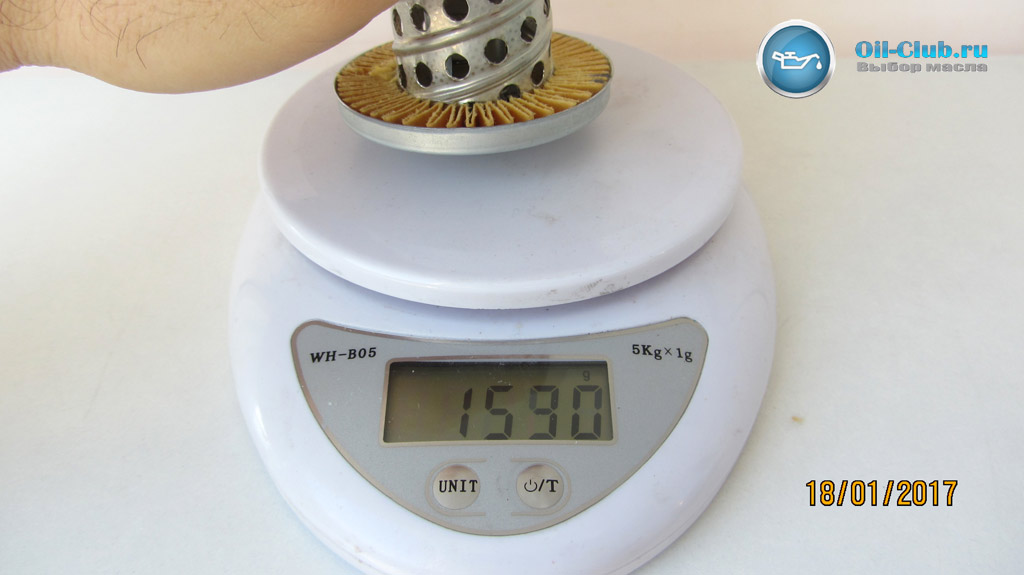

Давление необходимое для открытия перепускного клапана: вес = 1,6кг; ди=13мм; давление 1.2 бар - как по букварю... так и должно быть.
Полезная площадь фильтрующего материала: длинна = 134см x ширина 4,5см = площадь 603см2 - я считаю для такого маленького фильтра достойная площадь фильтрующего материала, единственное что он тонковат. (поэтому его больше и влезло.)
