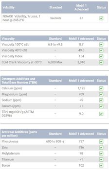

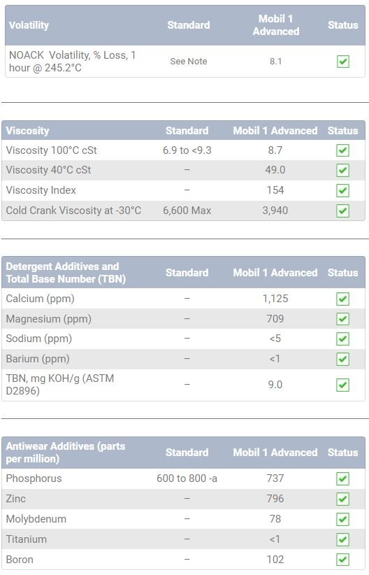

Product: Mobil 1 Full Synthetic
Viscosity Grade: SAE 5W-20
Labeled: API SP/ILSAC GF-6A
Manufactured By: ExxonMobil Oil Corporation, Spring, TX
Purchased at: Piscataway, NJ
Date of purchase: 03/22/2021
Mobil15W20.png?ssl=1      Mobil15W20Back.jpg                                 874853983_1520.thumb.JPG.52feaec29e7581bd74407096d44e6b2e.JPG
https://pqia.org/mobil-1-advanced-full-synthetic-5w-20-motor-oil/
