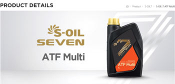

S-OIL7 ATF MULTI
image.jp.png.
Product Description
S-OIL 7 ATF Multi is a premium automatic transmission fluid based on highly refined API Group III base oil and suitable for use in wide range of Asian, European, American 4/5/6/6+ speeds ATFs. Its excellent thermal and oxidation stability prevents deposit or corrosive matters in your gear box, so It provides stable operation of your ATF and long oil life.
Applications
  •  4/5/6/6+-speed automatic gearboxes in Asian, European, American passenger vehicles
Features
  • 100% synthetic base oil helps maintain oils initial conditions thanks to good stability and high viscosity index
  • Exceptional friction and anti-shudder performances with advanced technology
  • Excellent viscosity stability in operation
  • Excellent thermal stability and resistance to oxidation
  • Very good wear protection
Performance Level
  • GM DEXRON II/IID/IIE/IIIG/IIIH/VI
  • Ford Mercon
  • Allison C4/TES-295/TES-389
  • Land Rover Texaco N402
  • Jaguar Idemitsu K17/Fluid 8432
  • Chrysler ATF+3/+4/SP-III
  • Esso LT 71141
  • JWS 3309
  • SSANGYONG DSIH 5M-66
  • Hyundai Kia SP-II/III/IV/IV-RR
  • JASO M315 1A
  • Toyota Type D-II/T/T-III/T-IV/T-WS
  • Mitsubishi J2/SP-II/SP-III
  • Mazda FZ/F-1/JWS3317/M-III/Type T-IV/M-V
  • Nissan Matic-D/J/K/W/S
  • Subaru ATF; plus ATF-HP
  • Isuzu ATF II/III
  • Suzuki 3314/3317
  • Honda ATF Z-1/DW-1
  • Volkswagen/Audi G052 025 A2/055/162(-A1/-A2)/533/990(A2)/G055 025(A2)
  • Renault Matic-D2
  • BMW LT71141/LA2634/ETL-7045E/8072B
  • Mercedes Benz 236.3/5/6/7/8/9/10/11/91
  • ZF TE ML 11A/11B
  • MAN 339A, Bentley, Porsche, PSA, Volvo ATFs
Typical Properties
Test Items Method Unit Typical properties
Specific gravity ASTM D1298 - 0.848
Color ASTM D1500 - Red
Viscosity 40℃ ASTM D445 cSt 36.8
100℃ ASTM D445 cSt 7.0
Viscosity index(VI) ASTM D2270 - 153
Flash point Cleveland ASTM D92 ℃ 232
Pour point ASTM D97 ℃ -46

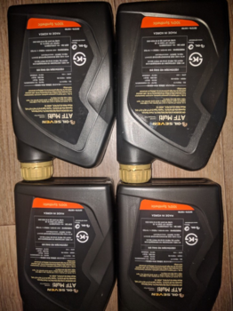

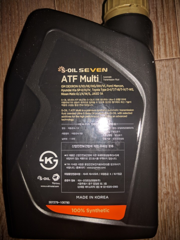

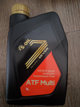

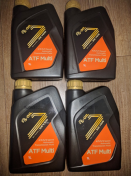

image.thumb.png.5724464fc14c76e073b5d466c5269178.pngimage.thumb.png.06b51b9b0ca55c11af659e355ca1c916.pngimage.thumb.png.558ae76b21e931cc5ea371e6ccd8778a.pngimage.thumb.png.9403c6740123d248d69b1cd25cd56cbc.png
Я купил его для обмена текучей средой.
100% синтетическое масло.
Производство S-OIL TOTAL.
В продаже продаются мощности 1L и 20L.
