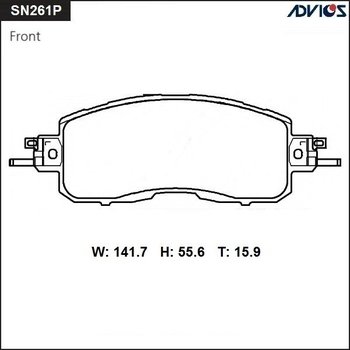

SN261P - (F) NISSAN ALTIMA / TEANA III L33 (2013-2018)

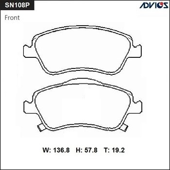

SN108P - (F) TOYOTA AURIS E150L (2006-2012)
