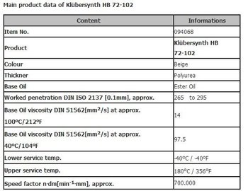

Klübersynth HB 72-102 is a synthetic lubricating grease covering the very wide temperature range needed, for example, in the automotive industry. The product constituents – ester oil, polyurea thickener and selected additives – ensure a consistently low oil release level at the different temperatures over a long time. Good resistance to hot and cold water and efficient corrosion protection contribute to a reliable operation of the bearing. Tests with some sealing materials like FPM, ACM and NBR confirm good compatibility with elastomers.
Benefits for your application
  • Tried-and-tested grease concept based on polyurea and ester oil
  • High-temperature grease for the lifetime lubrication of bearings in the automotive industry
  • Reduced maintenance costs due to high reliability
  • Proven effective for many years in clutch release bearings, therefore minimized risk in this application
