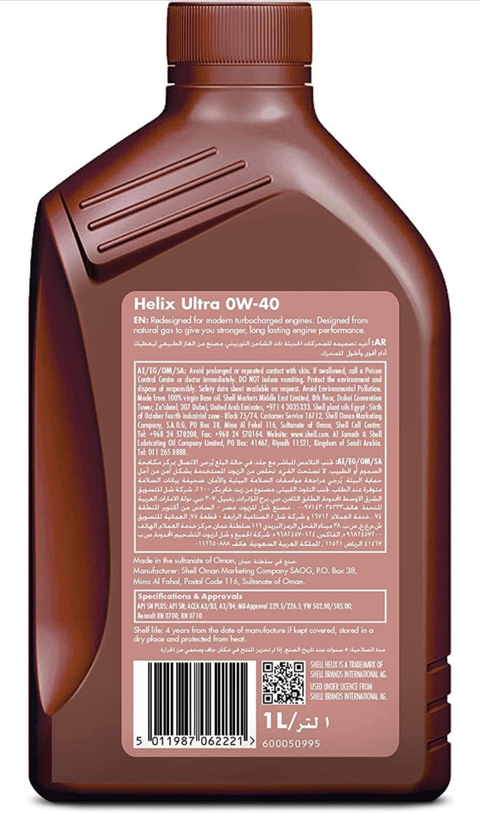

Oil: Shell Helix Ultra
Viscosity: 0w40
Classification: API SN Plus, ACEA B4
Packaging marking: For gasoline engines, without diesel engine.
Packing date: 07/2021 from factory (oil age two years before use)
