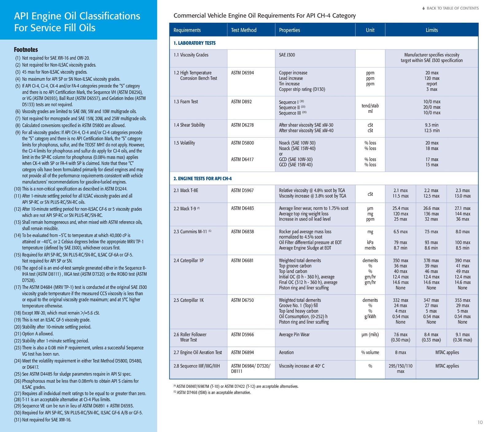

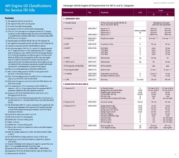

API Engine Oil Classifications

api-engine-oil-classifications-brochure2.pdf
