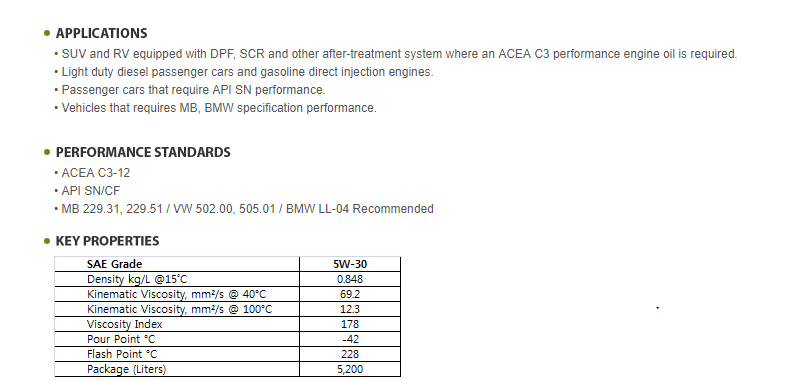

Спецификации: ACEA C3-12; API SN/CF; MB229.51; VW502.00/505.01; BMW LL-04.
Технические характериcтики:

http://kixxlube.gscaltex.com/ENG/Prod/product_intro_detail.aspx?pcode=EN00311&basecode=eng&LV1=Products(New Kixx)&LV2=Passenger Car
kIXX D1 RV 5W-30
40'C VIS 69.2
100'C VIS 12.3
VISCOSITY INDEX 178
POUR POINT -42
FLASH POINT 228
100% SYNTHETIC(VHVI)
