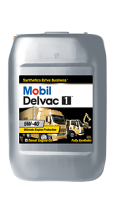

Mobil1 Delvac 5W-40 (SL, CI-4 PLUS, E7, DH-1, MB 235.28/228.5, Cummins CES 20078/20077/20076/20075, Ford WSS-M2C171-D, Volvo VDS-3/VDS-2)
Mobil1 Delvac 5W-40
Спецификации:  API CI-4 PLUS/CI-4/CH-4/SL/SJ, ACEA E7/E4, Cummins CES 20078/20077/20076/20075, Ford WSS-M2C171-D, Renault Trucks RXD, Global DHD-1, JASO DH-1, Detroit Fluids Specification Diesel 93K214, Mack EO-N Premium Plus 03, EO-M Plus, MB 235.28/228.5, Scania LDF, Volvo VDS-3/VDS-2
