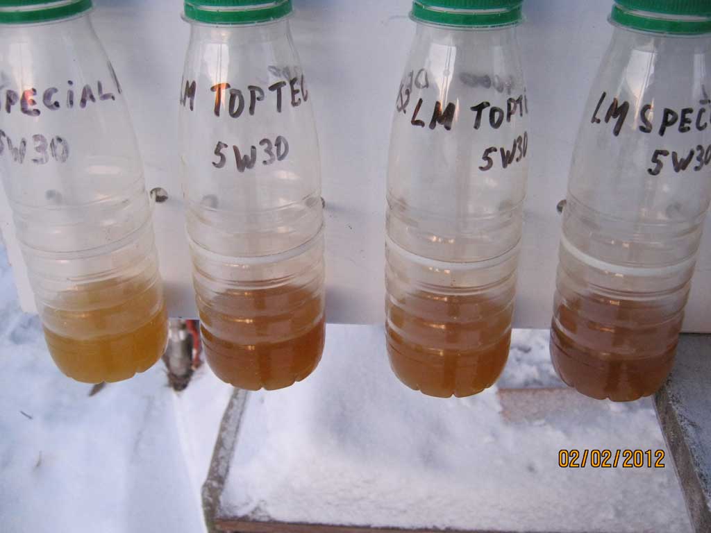

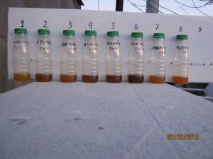

-28 Масла вязкости 5W-30 (тест посвящен Liqui-Moly)
Numbers (Номера масел)
1) Liqui-Moly Special AA 5W-30
2) Liqui-Moly Toptec 4200 5W-30
3) Liqui-Moly Toptec 4600 5W-30 (Dexos2)
4) Liqui-moly Special LL 5W-30
5) Meguin Quality 5W-30
6) NGN Nord 5W-30
7) Fuchs Titan Supersyn F 5W-30
8) Petro-Canada Supreme SN 5W-30
Winners (Победители по местам)
1) Fuchs Titan Supersyn F 5W-30 and NGN Nord 5W-30
2) Liqui-Moly Special AA 5W-30 and Petro-Canada Supreme SN 5W-30
3) Liqui-Moly Toptec 4200 5W-30
4) Liqui-Moly Toptec 4600 5W-30 (Dexos2) and Liqui-moly Special LL 5W-30 and Meguin Quality 5W-30
