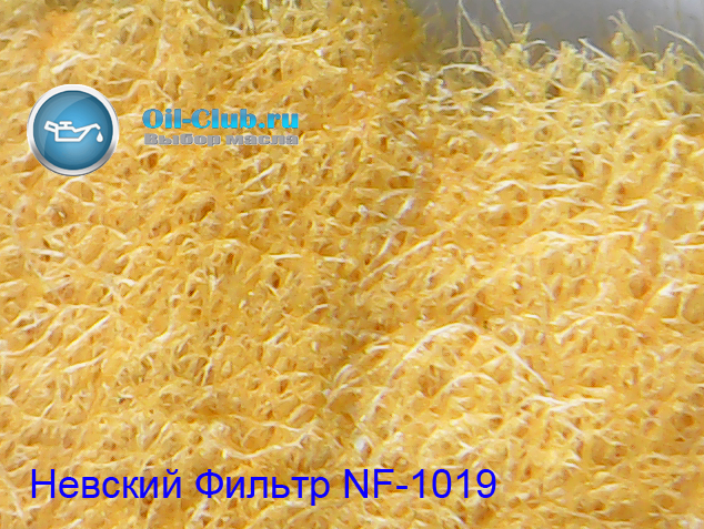

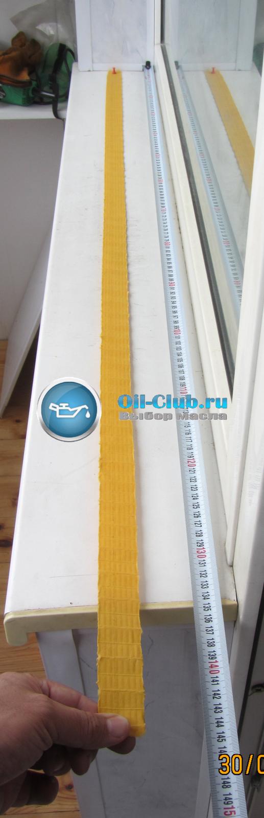

torcon 64 394 Опубликовано: 30 марта 2017 Поделиться Опубликовано: 30 марта 2017 Невский Фильтр NF-1019 за заказ экспертизы спасибо форумчанину nizh2. Фильтр приобретался в exist.ru по цене 123р. Применяемость: Hyundai Accent Hyundai Azera Hyundai Centennial Hyundai Coupe Hyundai Elantra Hyundai Equus Hyundai Excel Hyundai Genesis Coupe Hyundai Getz Hyundai Grandeur Hyundai Lavita Hyundai Matrix Hyundai Santa Fe Hyundai Santamo Hyundai Scoupe Hyundai Solaris Hyundai Sonata Hyundai Stellar Hyundai Terracan Hyundai Trajet Hyundai Tucson Hyundai Veloster Hyundai Verna Hyundai i20 Hyundai i30 Hyundai i40 Hyundai ix35 Kia Besta Kia Carens Kia Carnival Kia Cerato Kia Joice Kia Magentis Kia Opirus Kia Optima Kia Rio Kia Sorento Kia Soul Kia Sportage Kia Venga Kia cee'd Mazda Bongo Brawny, SKE6T, SK24L, SK56M, SKE4T, SKE6V, SR5AV, SRE9W, SD5AT, SD29M, SK26T, SK24T, SKF6M, SD59T, SR2AM, SREAM, SR89V, SKFHM, SK5HV, SD5AM, SR29V, SK56L, SK54L, SD59M, SKF6V, SD2AT, SRF9W, SRE9V, SR2AV, SK56T, SK54T, SK56V, SR5AM, SK54V, SD29T, SDEAT, SRS9V, SK5HM, SD89T, SKFHV, SRSAV, SR59V, SREAV, SD2AM, SK26L Mazda Bongo, SS28H, SK22M, SKF2L, SKF2V, SE88M, SS88W, SSF8W, SSE8R, SKF2T, SS48V, SSF8RE, SK82V, SS88R, SK22V, SSF8WE, SK82T, SS28V, SS88H, SE58T, SK22T, SS28R, SS28ME, SK82L, SK22L, SSE8WE, SE88T, SKF2M, SS88V, SSE8W, SSF8V, SE28M, SSF8R, SEF8T, SE28T, SE28R, SS58V, SE48T, SS28M, SS88M, SK82M Mazda Capella Cargo, GVFR, GV8W, GV6V, GVER, GVFV, GVFW Mazda Capella Wagon, GVEW, GWFW, GVFW, GWEW, GW5R, GVER, GWER, GW8W, GV8W, GVFR Mazda Capella, GDEA, GDES, GC8J, GC8P, GD8S, GC6P, GC2210, GCFJ, GCFP, GD8A, GCEP, GFEP, GDER, GFER, GC1412, GD8J, GD8P, GF8P, GD8R, GD6P, GDEB, GDFJ, GD8Y, GDEP, GFFP, GDFP, GD8B Mazda Etude, BFSP, BFMP Mazda Eunos Cargo, SSF8WE, SSF8VE, SS28ME, SSF8RE, SSE8WE, SE58TE, SS58VE, SEF8TE, SE28ME Mazda Familia Van, BF3V, BF5V, BF5W, BF6M, BW5W, BW7W, BF7V, BWMR, BW3W Mazda Familia, BFMR, BJFW, ZR16UX5, BFMP, BG8Z, BG6Z, BG8P, BJ5W, BG7P, BG6P, BG8R, BFTP, BG5P, BJ8W, BG6R, BFSP, BG3P, BFSR, BJEP, BJFP, ZR16U85, ZR16U65, BJ5P, BG3S, BF7P, YR46U35, BF5P, YR46U15, BG8S, BF5R, BF3P, BG6S, BJ3P, BG8RA, BG5S Mazda Ford Telstar II, GF8PF, GFERF, GFFPF, GFEPF Mazda Ford Telstar Wagon, GWFWF, GWERF, GW5RF, GWEWF, GW8WF Mazda Titan, SYF6T, SYF6L, SYF4T, SYF4L Mitsubishi Airtrek, CU5W, CU2W, CU4W Mitsubishi Aspire, EA7A, EC5A, EA1A, EC3A, EC7A, EC1A, EA3A Mitsubishi Bravo, U42T, U41V, U42V Mitsubishi Carisma, DA2A Mitsubishi Challenger, K96W Mitsubishi Chariot Grandis, N84W, N94W Mitsubishi Chariot, N34W, N43W, N44W, N33W, D08W, D05W, D03W, D02W Mitsubishi Colt, Z28A, Z27A, Z27WG, Z26A, Z25A, Z27W, Z27AG Mitsubishi Debonair, S26A, S12AG, S27A, S11A, S22A, S12A Mitsubishi Diamante Wagon, F07W Mitsubishi Diamante, F11A, F25A, F13A, F34A, F27A, F15A, F17A Mitsubishi Dingo, CQ5A, CQ2A, CQ1A Mitsubishi Dion, CR5W, CR6W, CR9W Mitsubishi Eclipse Spyder, D38A Mitsubishi Eclipse, D32A, D27A, D22A Mitsubishi Emeraude, E84A, E74A, E52A, E72A, E54A, E64A, E53A Mitsubishi Eterna Sava, E39A, E32A, E37A, E35A, E33A Mitsubishi Eterna Sigma, E12A, E13A, E18A, E17A, E15A Mitsubishi Eterna, E35A, E39A, E64A, E52A, E33A, E72A, E54A, E32A, E84A, E53A, E74A Mitsubishi FTO, DE3A, DE2A Mitsubishi GTO, Z15A, Z16A Mitsubishi Galant Fortis, CZ4A Mitsubishi Galant Sigma, E12A, E11A, E15AK, E13A, E17A, E15A Mitsubishi Galant, E64A, E84A, E18A, E52A, E53A, E74A, E31A, E72A, E33A, E32A, E54A, E35A, E13A, E37A, E15A, E39A, E17A, E38A, EC3A, EC5A, EC7A, EA7A, EA3A, EA1A, EC1A Mitsubishi Grandis, NA4W Mitsubishi Lancer Cedia, CS2A, CT9W, CS5A, CS6A, CT9A, CS2W, CS2V, CS5W Mitsubishi Lancer Evolution, CZ4A Mitsubishi Lancer Wagon, C12W, C11V, C12V, C37W, C32V Mitsubishi Lancer, CT9A, CL2A, CJ1A, CJ2A, CN9A, CP9A, CJ4A, C61A, CS2W, CS5W, C63A, C62A, CS5A, CS6A, CM2A, CK1A, CK2A, CS2A, C12A, C11A, C13A, CM5A, CK4A, C18A, CK6A, C72A, CS2V, CT9W, CE9A, C73A Mitsubishi Legnum, EC4W, EA1W, EC5W, EC7W, EA7W, EA5W, EC1W, EA4W, EA3W, EC3W Mitsubishi Libero, CB2V, CB4W, CD5W, CD2V, CB2W, CB1V, CB5W Mitsubishi Minica, H14A, H15A, H14V, H15V, H11A, H11V, H12V Mitsubishi Minicab, U14TP, U14T, U15V, U15T, U12V, U11V, U14V, U12T, U11TP, U11T Mitsubishi Mirage, CE9A, C12W, C72A, C51A, C73A, CK2A, C63A, CM5A, CM2A, CK1A, CK6A, CK4A, C37W, C11V, C12V, C32V, C18A, C12A, C13A, C11A, C61A, C62A, C83A, C52A, CP9A, C53A, CJ2A, CJ1A, CL2A, CJ4A, CN9A Mitsubishi Outlander, CW6W Mitsubishi Pajero iO, H67W, H77W, H76W, H66W, H61W, H72W, H62W, H71W Mitsubishi Pajero, L146G, V93W, V23C, L141G, V97W, V23W, L041G, V21W, L046G Mitsubishi RVR, N74WG, N23WG, N71W, N61W, N23W, N13W, N64WG, N73WG Mitsubishi Space Gear, PD6W, PC4W, PB4W, PD4W, PF6W, PA4W, PA3V, PB6W Mitsubishi Starion, A187A, A182A, A183A, A184A Subaru Legacy, BEE, BHE, BLE, BRF, BPE Качественная ламинированная коробка. Указаны замены, сайт, телефоны, производитель - очень информативно. Но к сожалению нигде не указано "Сделано в России" - так как в последнее время, многие производители, по всякому жонглируют словами, лишь бы не указывать страну производства Китай, можно например выстроить теорию заговора, что Невский фильтр вообще в России фильтров не делает, или делает но не все модели... А на упаковке указывает только зарегистрированную контору. Поэтому лучше конечно писать Сделано в России. Мое мнение как обывателя, если оно кому нибудь вообще интересно :) Корпус Невского Фильтра окрашен в белый цвет, указана дата выпуска, сайт, логотип. Внутри корпуса чисто, немного краски, что нормально. Фильтрующая катушка - сразу три минуса. Из за системы противодренажного клапана - мало места для фильтрующей катушки, поэтому она маленькая. Дешевый, тонкий фильтрующий материал. Не аккуратно "устряпан" клеем-герметиком. Противодренажный клапан занимает уж слишком много пространства в небольшом корпусе - минус. Перепускной клапан выполнен из резины, на нажатие тяжелый. На весах не уловил момент, на самом деле вес открытия около 1.9 кг Противодренажный клапан - резиновая шайба. Такое исполнение нормально, так как на противодренажный клапан давит подвес из пластинки и пружинки. Резьба нарезана хорошо, чистая, метал потускнел... С обратной стороны прижимное резиновое кольцо, квадратного сечения, мягкое. Здесь все в норме. Прижимная низкопрофильная пластина. Хотя бы она не скрадывает пространство у катушки... Представьте если бы была большая "слонобойная" пружина... Фильтрующий материал, если присмотритесь с небольшими просветами - в смысле мелкими отверстиями. Жидковат... По толщине в сравнении с мерным эталоном - я бы сказал у Невского Фильтра NF-1019 средняя толщина. Фильтровальная штора длинная = 145см, но ширина ее не впечатляет = 3,2см. Вид под микроскопом, никаких проблем, единственное если заметили - рыхловат... Давление открытия перепускного клапана: вес = 1.9 кг; диаметр = 12мм; давление = 1,7 бар - может я не правильно рассчитал, получилось чуть выше нормы. Полезная площадь фильтрующего материала: длина = 145см; ширина 3,2см; площадь = 464см2 - буквально вчера я вскрывал фильтр другого производителя, для этих же моделей автомобилей, в таком же размере корпуса, там была площадь = 917см2 - при этом качественного, толстого, плотного материала. В общем производителю есть к чему стремиться. Вывод: Фильтр на тройку. Маленькая катушка в большом корпусе - много места "украл" подвес противодренажного клапана. Мало фильтрующего материала для такого фильтра. Фильтрующий материал дешевенький. Неаккуратности с клеем-герметиком. В остальном резьба нарезана чисто, резиновое кольцо нормальное. Цена дешевая - 123р. 4 Цитата Ссылка на сообщение Поделиться на других сайтах
Pinachet 162 Опубликовано: 30 марта 2017 Поделиться Опубликовано: 30 марта 2017 (изменено) Давление открытия перепускного клапана: вес = 1.9 кг; диаметр = 12мм; давление = 1,7 бар Полезная площадь фильтрующего материала: длина = 145см; ширина 3,2см; площадь = 464см2 - А вот и причина стука в двигателе при холодном пуске (+лампочка давления) - высокое давление открытия перепускного клапана при малой площади фильтрующего материала, приходилось с подобным сталкиваться. Изменено 30 марта 2017 пользователем Pinachet 1 Цитата Ссылка на сообщение Поделиться на других сайтах
